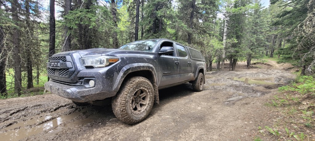

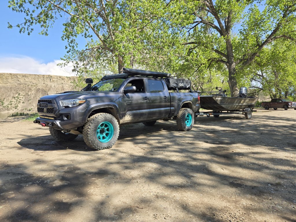

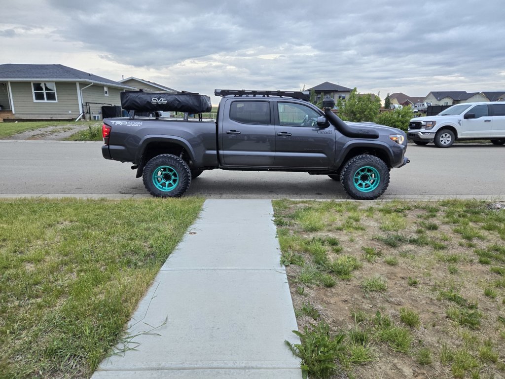

    I’m not on a 2/1 setup, but closer to it as I’m running Deaver’s stage 1s right now and that’s putting me up in the rear, but I’m hoping to run a shell soon.
    6112 up front, about 2.2
    Deaver’s stage 1 rears, about 1.5 net; 5160s
    SEMA wheels, 17x7, 4 offset
    285/70/17 Maxxis Razr AT
    I didn’t want a wider wheel as I plan to continue to run the Razrs or skinnies.the Razr is a hair smaller than the normal 285/70/17, which helps minimize rubbing and weight.
    quietest AT I think I’ve ever run
    it’s my daily, the wheel and tire setup is about 70 lbs per corner as the tire is only 46lbs I believe, a featherweight. It’s. C class tire, but I’ve heard from others they’ve had 0 issues both on and off road.
    Without the oem mud flaps, if I’m at full lock and flexed a decent amount, I’ve rubbed a bit, but barely considering, aside from that, naw.

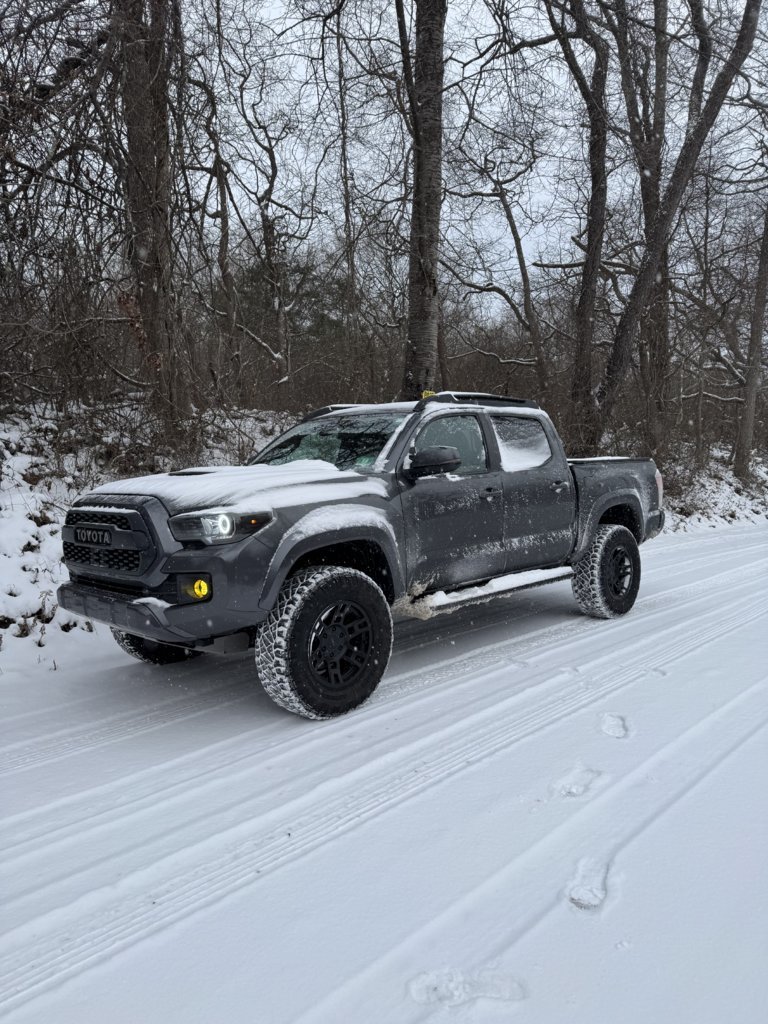

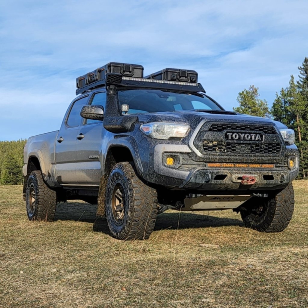

    18 Tacoma DCLB sport

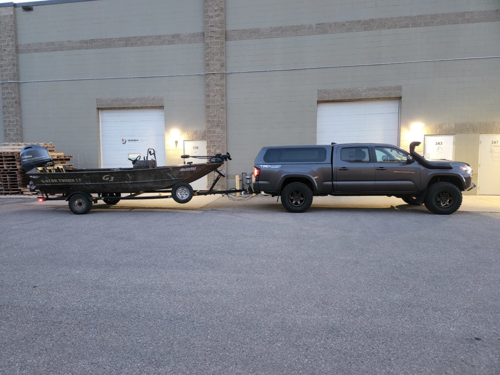

    2" front 1" rear, dirt king uca's, high castor alignment, fender liner trim and tuck up front, rok blokz mud flaps, 17x9 +1 285/70r17
    That was an old set up. If you daily the truck i would strongly look at 265/70r17's no lift or 255/80r17's no lift on a 0 offset wheel.
    You get a huge increase in a cool offroady look without all the pains thst come with lifting and big tires. Like potential for vibrations increased component wear and tear and loss of fuel economy.
    17x9 +1 267/70r17 all stock suspension it truly is the best balance for a daily.

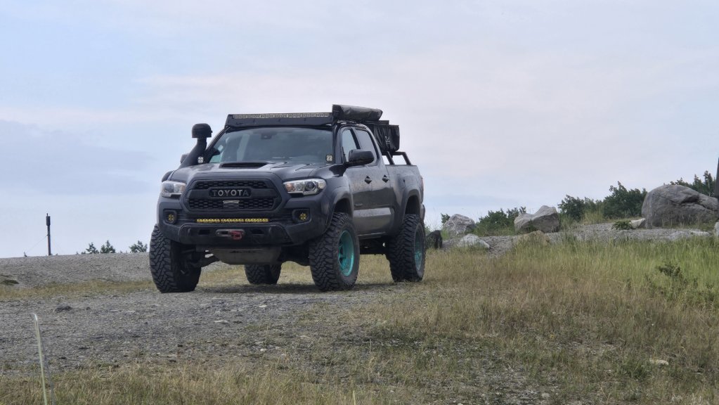

    That set up with a greenlane stump bumper and a diode dynamics 30" bar i built mounts for.
    I swapped my lighting set up for a baja designs s8 and sae fog lights this summer.

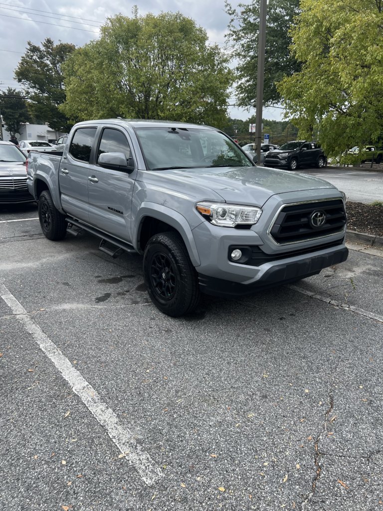

    EDIT: Looking to do: 265/70R17s
    Wheel Specs of my 2021 TRD Sport:
    Wheel Diameter 17.0 x 7.5 in
    Rear Wheel Diameter 17.0 x 7.5 in
    Wheels aluminum with painted accents
    Source: https://www.iseecars.com/car/2021-toyota-tacoma-wheel-rim-size

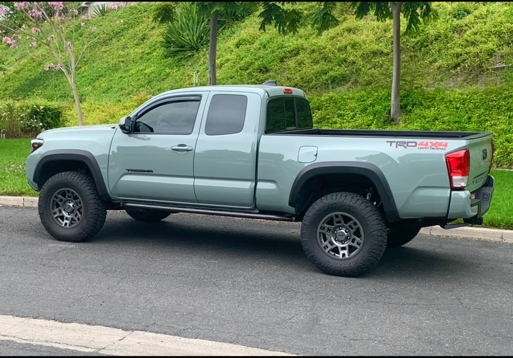

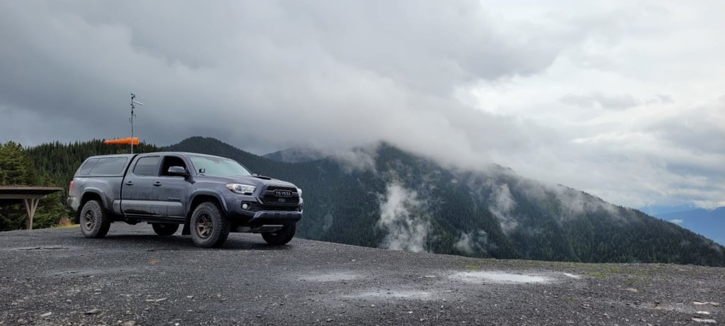

    Yep changing that offset goes a long way to improving the esthetic of the truck. You can just add a 1.25" spacing to a stock wheel but personally I'm not a fan of adding extra failure points in my wheels. Stock sport offset is +33 if i recall right and converting a 1.25 spacer is 31.75mm so it damn near puts you at a +1 offset.
    I would stick to a 0 if you want the best odds of no rubbing with a one sized up tire. Definitely recommend wider mud flaps if you like your paint. I used rokblokz XL's even with my 285's but had to remove the fronts after a cmc for 295's and -38 offset and i miss them don't want to know what my rear flares look like since removing them.
    That shows the fitment a bit better

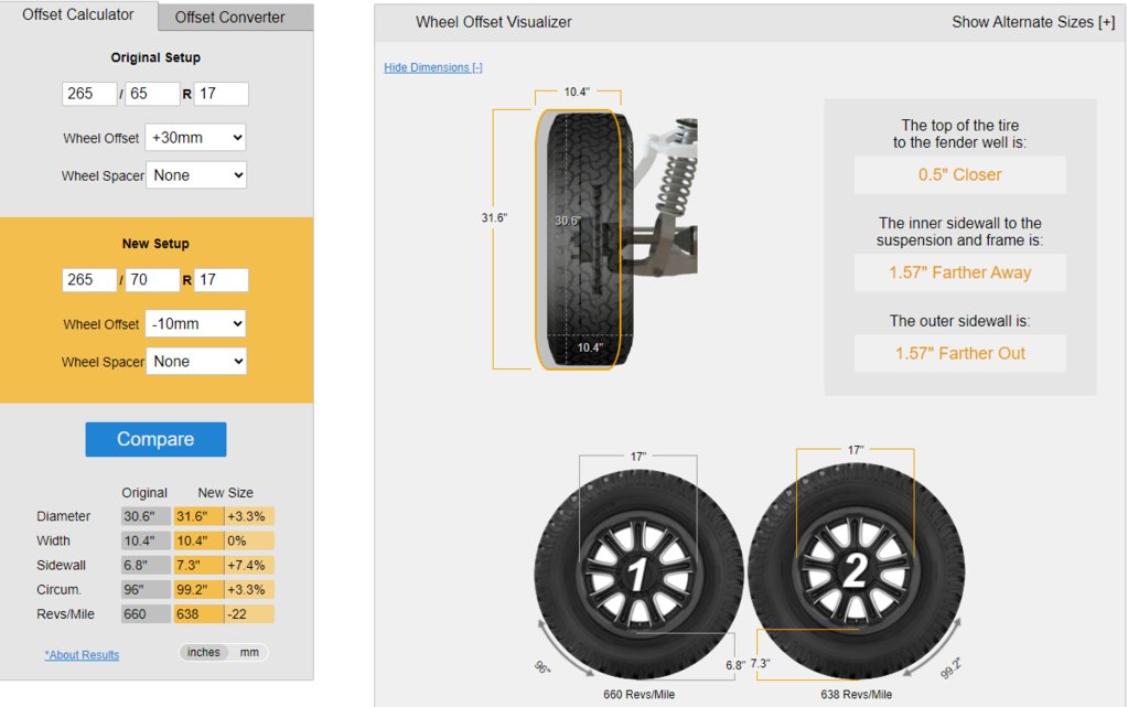

    I'm looking at Bilstein 5100s Leveling Kit and utilize the 2" setting.
    This would allow a bigger tire that's not too crazy...and crazy for me is 285s. lol upload_2025-1-13_14-4-45.png

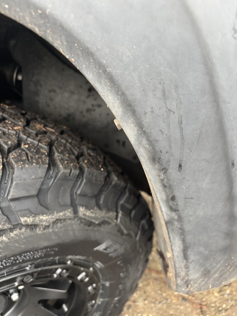

    908tacoma
    908tacoma Well-Known Member
    Oct 5, 2018
    #268429
    1,090
    New Jersey
    2018 MGM
    OME, SPC, TRD

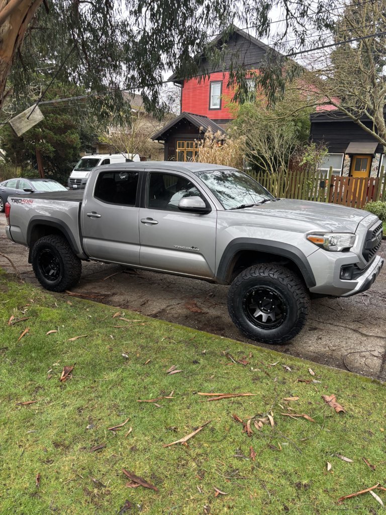

    I am running 17x8 not 8.5 with zero offset and 285/70 daily driver . Pic for reference IMG_9787.jpg
