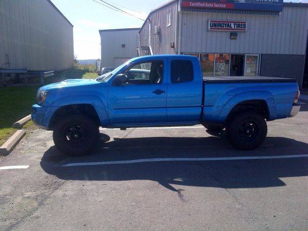

    All season mats, 2nd filter delete, DT header, Jardine cat-back, URD shifter, Bilstein 5100's all around at .85 front with Eibachs + .25 passenger/.5 drivers spacers and 1.5 AAL, 0w20 synthetic, Scanguage II, extra D rings, OEM backup camera+Mirror, bed mat, Extang Solid Fold, Popnlock 5300, Pro Comp 7089's 4.5bs 285/70/17 Revo 2s, De-badged
    those tires look badass with that lift. Wish i seen this pic before I would have got them. I like mine but not that beefy
    Personally I think the A/Ts and M/Ts lose their appeal after a while if you dont do serious wheeling. They annoy you on the highway, and I am a mpg whore so I hate when I lose them. The extra weight 24/7 is also a reason I went back to a lighter tire.
    Heres my before/after with 265 BFs and 285 Revo2s
    before
    after
    you can see the 285s really fill the wheel space out
