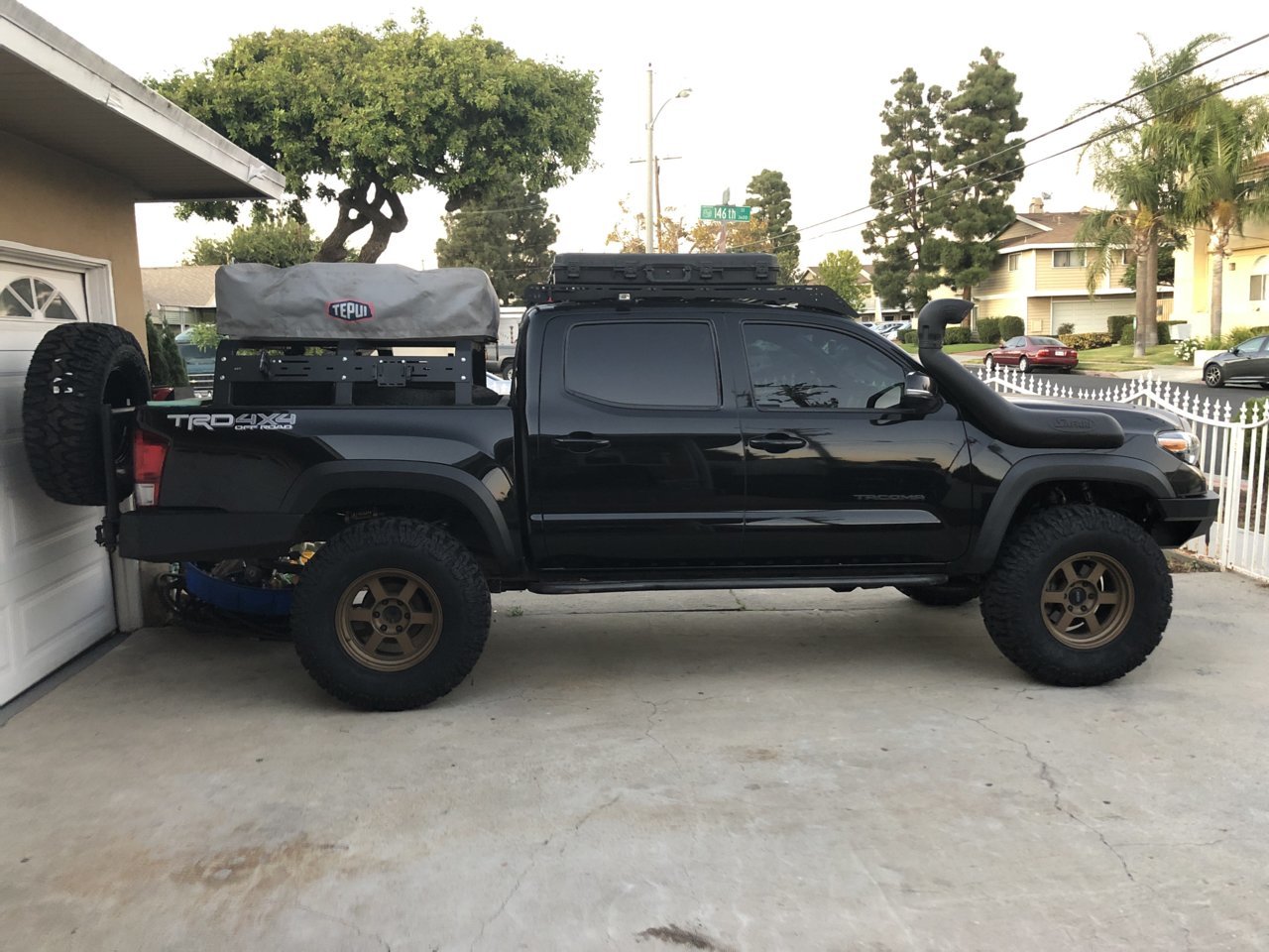

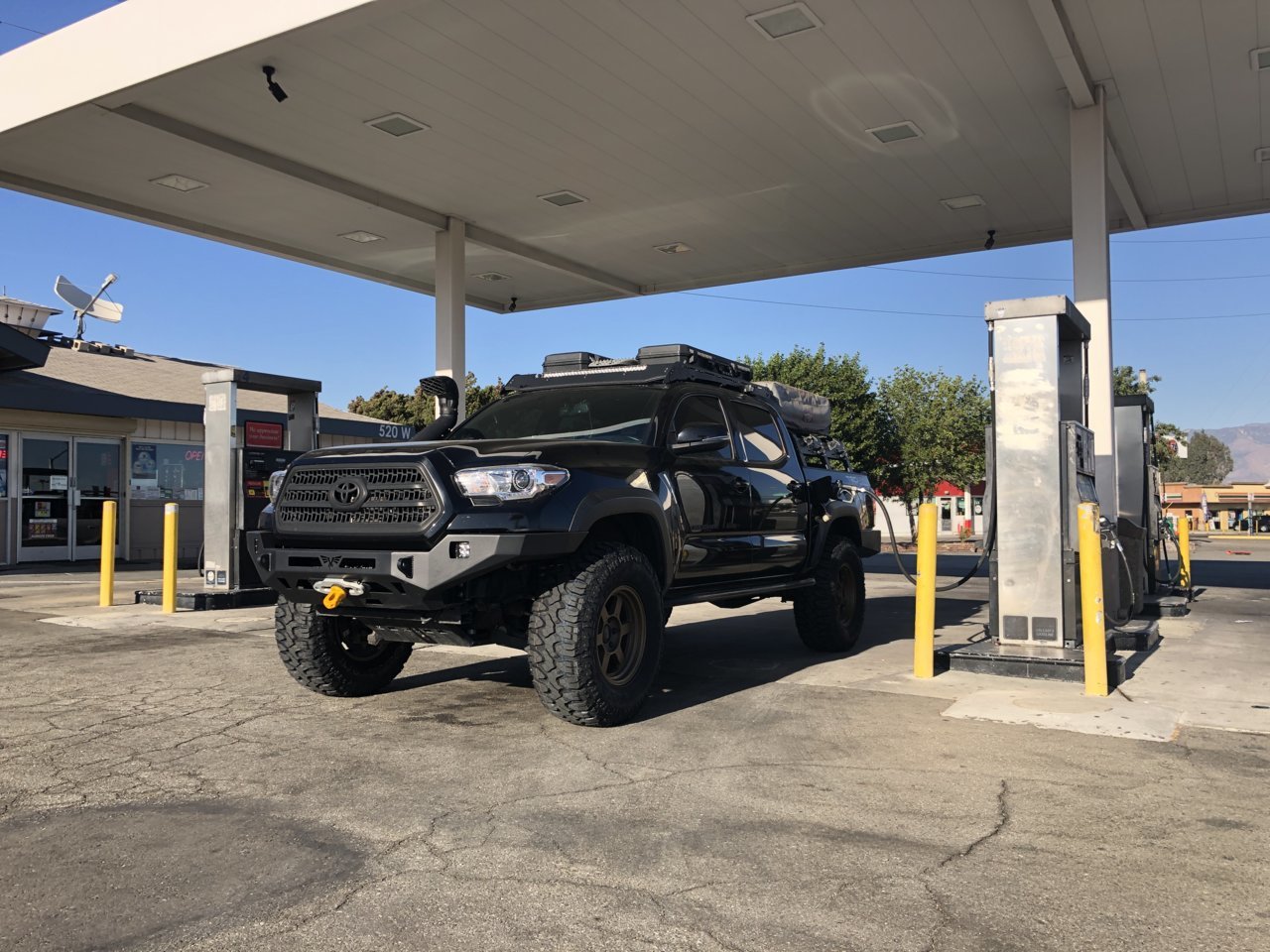

    Icon Stage 4 lift kit w/17 in ambit 4RR wheels and toyo open country at2 tires, ARB Twin air compressor, ARB breather kit, Plasti-Dip Grille, emblems and rear bumper, windo tint. Prinsu cab rack and black oak 30" single row 5 watt orsam LED bar enroute.
    E5035667-55AD-4E01-B7C2-A306A2D71AE6.jpg 9DFB9D2A-0FD8-4A38-A6CB-ABBEE25EF48C.jpg 9DFB9D2A-0FD8-4A38-A6CB-ABBEE25EF48C.jpg E5035667-55AD-4E01-B7C2-A306A2D71AE6.jpg Just spent an hour reading this thread! Love it hahaha... I made the jump to 315/70/17 Milestar Patagonia MT a few weeks ago wrapped around 17” relations race wheels RR4, and just threw on 5.29 nitros over veterans day weekend... i have an aggressive CMC and castor set to 3.5. I’m running an Icon stage 4 setup with #700 coils. In the street I just barely rub my sway bar at full lock... going to trim the fenders this weekend before I hit the trails the following weekend...
    I feel like 35’s just take constant tweaking until you get them just right (referring to cutting, possibly spacers, alignment). E5035667-55AD-4E01-B7C2-A306A2D71AE6.jpg9DFB9D2A-0FD8-4A38-A6CB-ABBEE25EF48C.jpg
