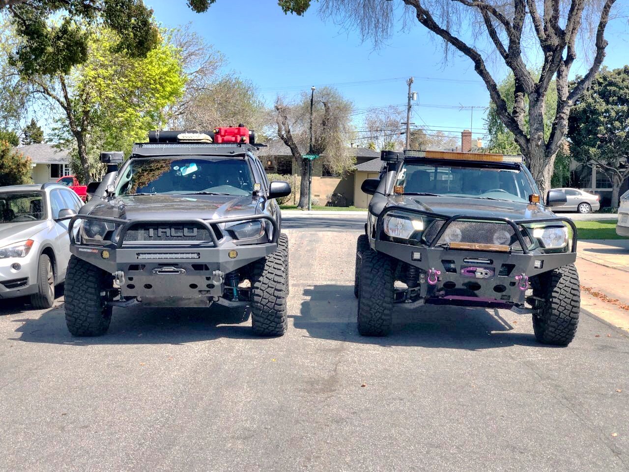

    Still catching up so it may have been noted or a comparison.
    They are 2nd gens but 315/70/17 and 295/70/17 KM3s both on SCS Ray 10 3.5 BS at least give you a side by side. The 295’s are still pretty wide.
    I’m in the middle of working through fitting them.

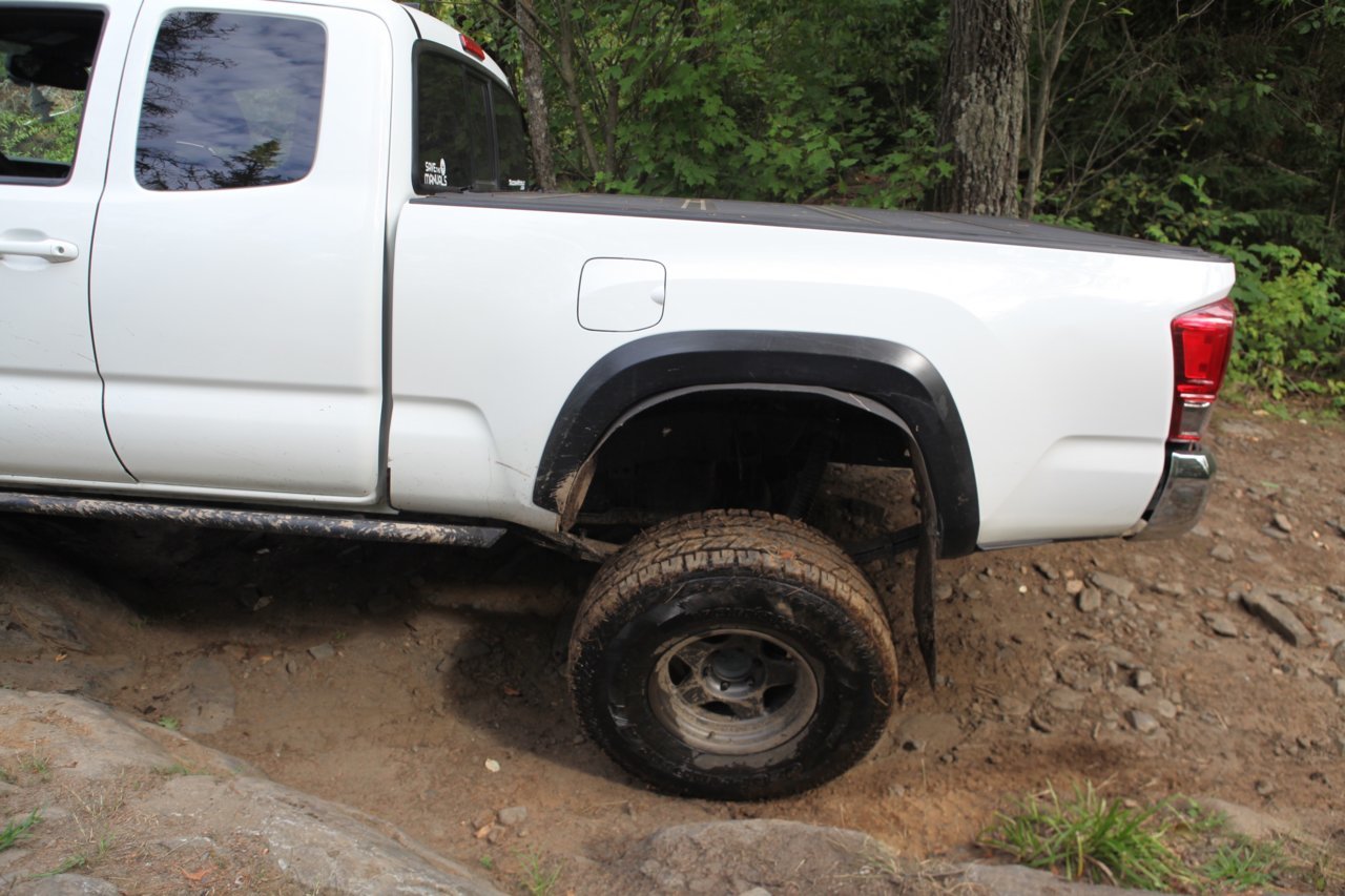

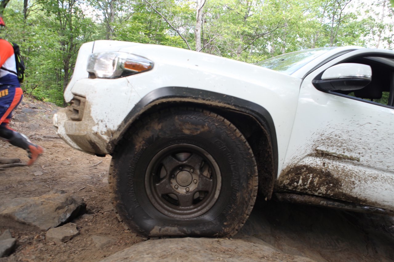

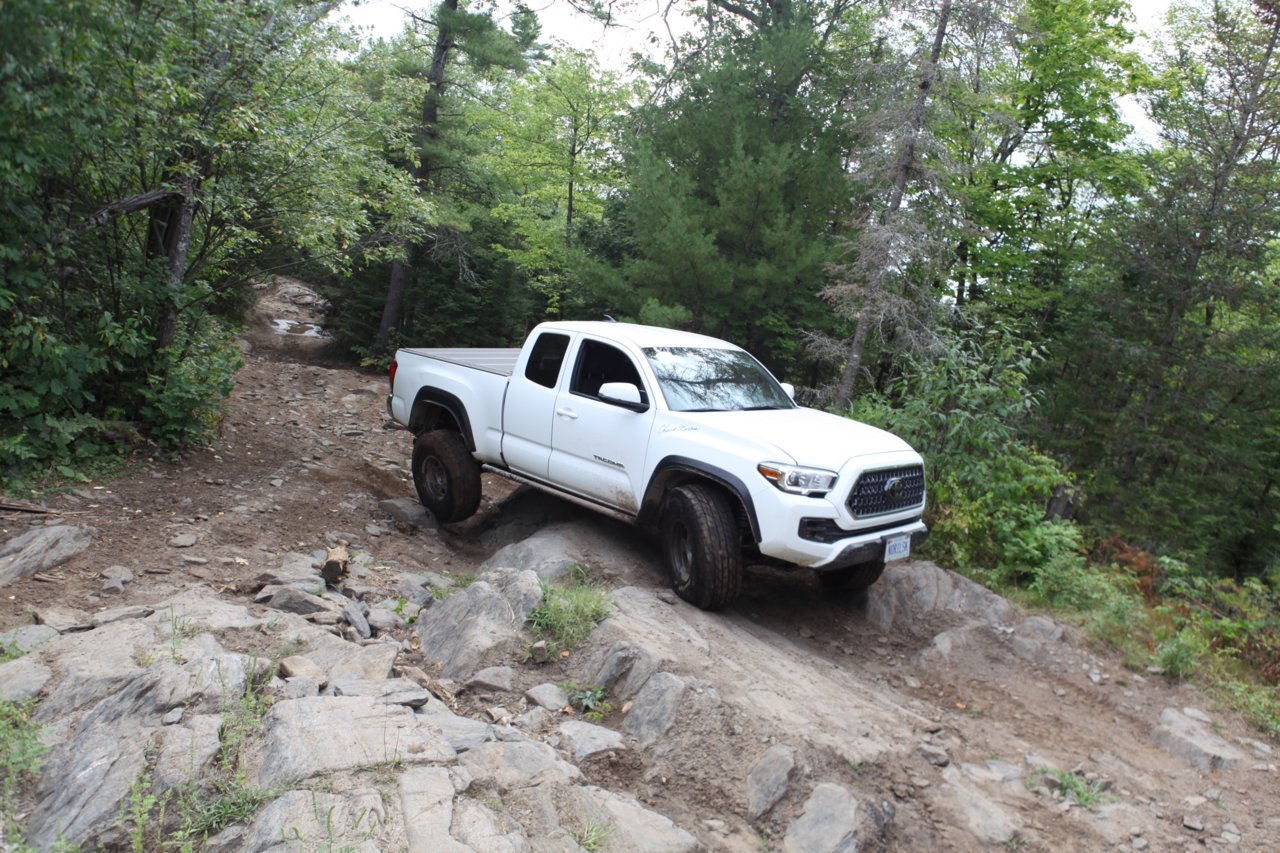

    I use SCS F5s with 3.5 backspace and -25mm on 16x8 wheel.
    Had to chop cab mount all the way to a bolt and trim front fenders (1” lift up front for now duh..., 3” coming). Gusset spindles, gusset alignment tabs and bunch of other little things - it works well on trails. There is rub on cab mount in reverse and at full lock occasionally, but I don’t turn my wheels all the way on a regular basis. I can live with a bit of rub for now.

    Looks like you do a fair bit of flexing, good to know that’s all the rubbing you get. What size tire exactly are you running?
