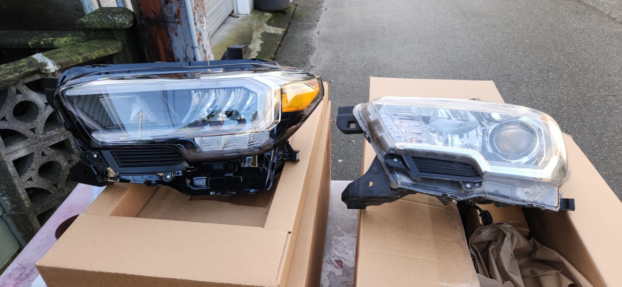

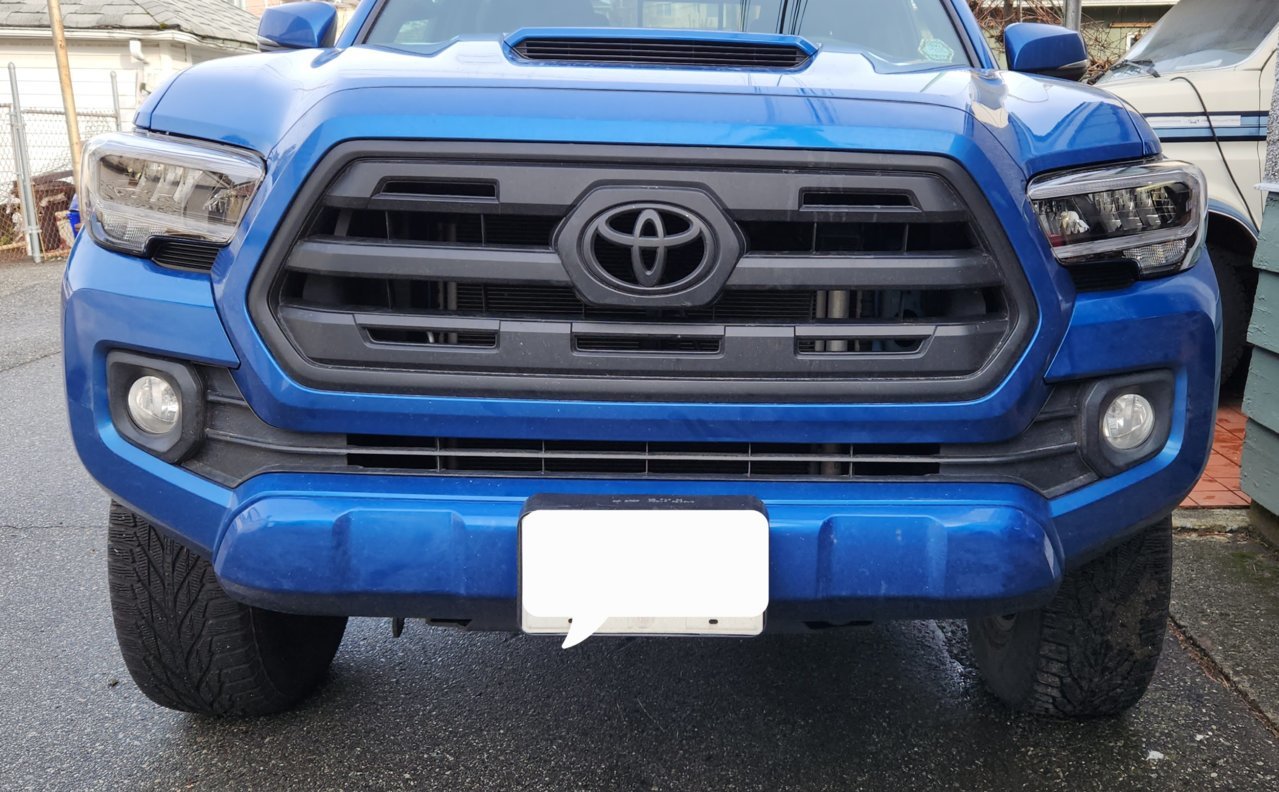

    Factory LED assemblies are your best bet. They came as an option on 2020 and up TRD Sport and Off-Road in the US, and factory equipment on 2020 TRD Pro's. And they are DOT legal.
    Putting LED bulbs into factory halogen assemblies are useless, and illegal in most regions. They are not DOT legal.
    I chose factory LED assemblies. I am both impressed and very pleased with the upgrade.
