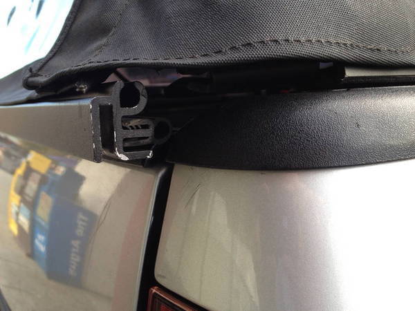

    Here you can kind of see where and how I'm trying to put in the rear piece. Rotated the bar inward and the crevice doesn't fit the tab
    After going through some threads, I realized I had that piece on backward, so I flipped it and it's still not really lining up. Also rotating the bar inward so the crevice faces the tabs
    For now I just have it unhooked and hanging, but I purposely flipped it the other way because if I don't rotate it and let it hang, the piece that touches my tailgate is the rubber seal, so I don't have to worry about scratches

    The rubber should be on the top of the tail gate. It fits you just have to force it on. You want it to be tight.

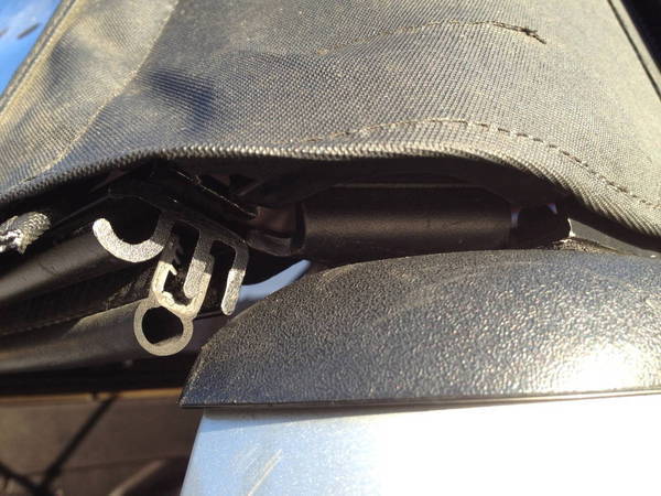

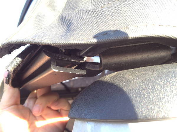

    I tried putting mine on today/tonight. I'm havin a heckuva time with the freakin tailgate bar. Is the Bulbseal supposed to go on like in the 2nd pic? I put mine on the other lip and then I could pick which slot the tailgate bracket hooked into...did I do it wrong? The tailgate bar and windows gave me a lot of trouble. Still don't have em on. It got dark on me so I left em off and I'll work with em when I have time this week.

    Yea the correct way to put it on is in the second picture. You want to make it so that after you rotate it, and about to put it into the tabs, the bulb seal is at the bottom, hitting your tailgate.

    I tried it that way an then thought surely that's not how it goes on. It made more sense to me the way I ended up doin it. I'll have to play with it again when I get a chance.

    Ok so to revive this thread one more time.... I put my bar on the way picture 2 is, and thats definitely the way it goes.... my back window is nice and taught now, no longer floppy...and the rubber part does seal the tailgate from the elements now better too
