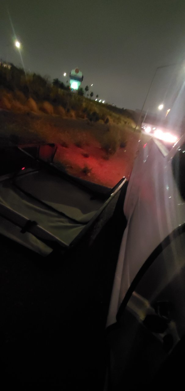

    I was driving down the highway at about 70mph and my bestop softtop literally flys up and off the bed of my truck lol. I look in my rear view and see it flying in the wind, luckily it lands in the emergency lane. I'm able to pull over and throw it back in with a strap. The metal frame bent. I had it for a year with no probs. I'm sure I had the c clamps down tight. 20200618_043056.jpg

    Softtop on the bottom left floor in the emergency lane of the freeway

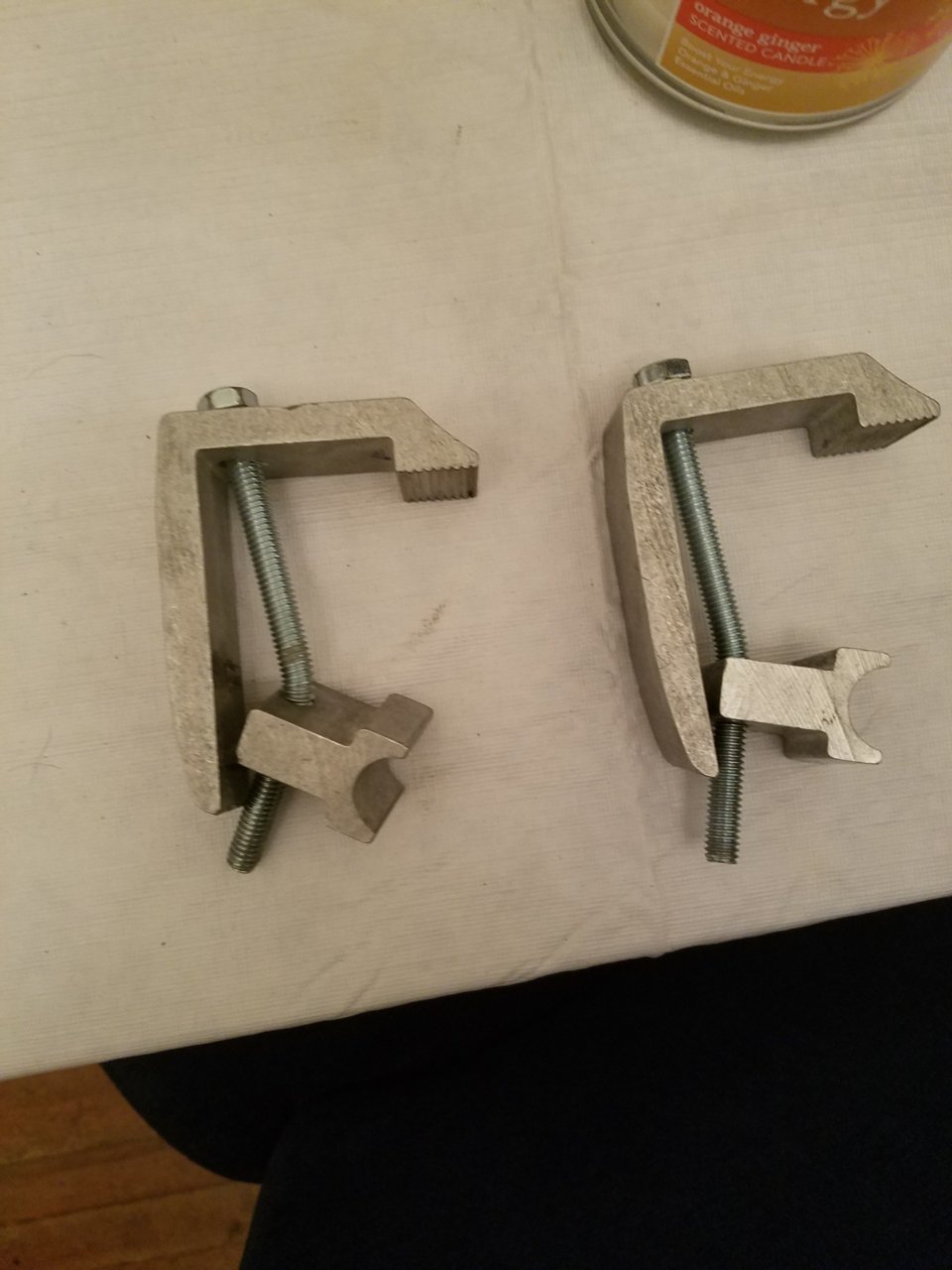

    Nope. The 80 mph wind sheared the shitty generic c clamps. 20170501_204652.jpg

    Softtoppers c clamps are much better.

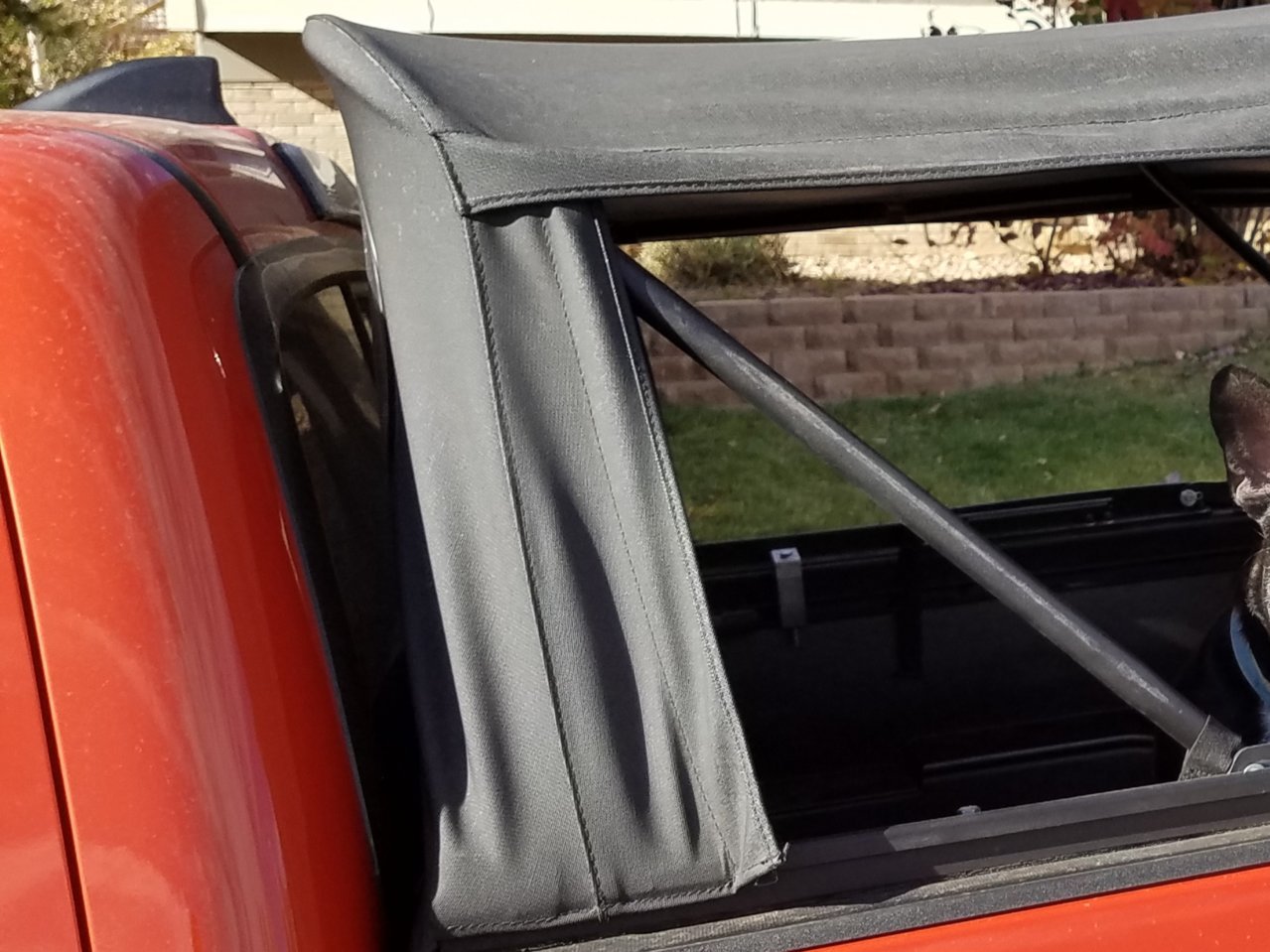

    And this is the area that creates a great little pocket for wind resistance. This was adjusted all the way possible towards the cab. Again this is the 2nd gen version on the 3rd before they actually made a redesign and stopped selling the wrongly label Besttops.

    I always cut out that clear vinyl between the topper and cab, so maybe it's not as much of an issue

    maybe 3 clamps per side? :notsure:

    Lol my clamps looked like that too, the screws bent. C clamps were and felt really cheap, I shoulda reinforced it with something else

    Yeah the clamps were bent along with the actual metal frame that lays on the top of the bed sides
