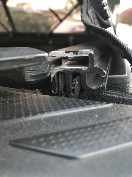

    So actually it looks like you have it on right, I had the similar issue when I first installed it. I had to push the rails forward towards the cab

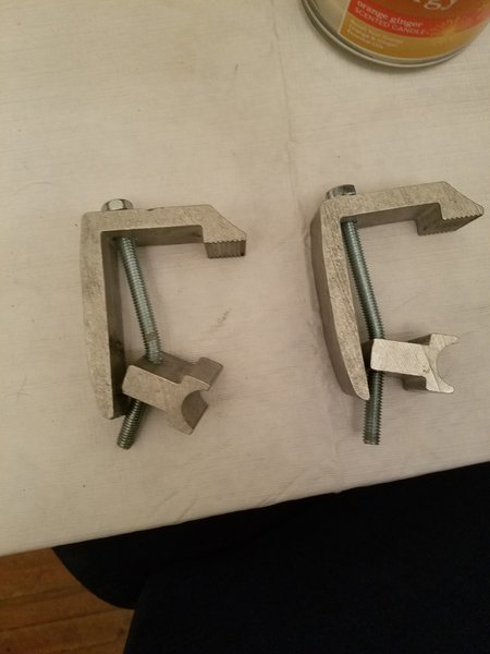

    Secure your top! Mine blew off in a crazy powerful wind storm. Sheared and bent the middle bolt of the front 2 clamps. These Bestop have not been redesigned for the 3rd generation Tacoma. There is a massive gap between the truck cab and the front of the topper and it sits naturally higher than the cab. My theory is it created a nice pocket for the wind. Anyways I hope this helps maybe get a few more clamps :confused:20170501_204652.jpg
    TeecoTaco likes this.

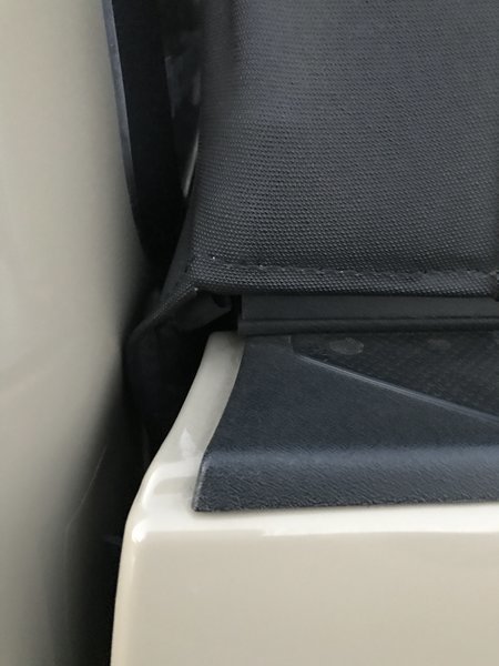

    Yup I loosed the 4 clamps and moved the besttop forward, I bought it used so I had to install without any instructions. This is where it sits on both sides. The rail is flush with the bed cap on both sides. Make sure the little flip doesn't touch the cab because it will run the clear coat when the bed flexes! :eek: Don't ask how I know! :anonymous: But I did end up buffing it out. IMG_1650.jpg

    Willing to sell your clamps??

    Sure :rofl: I have 2 non bent ones.
