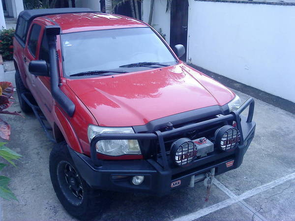

    Thks NYCO!:eek:
    Here´s a pic from another angle....

    A bumper with winch, snorkel and bestop are 3 of my most coveted mods. Awesome set up you have. The DR must be an awesome place to explore.

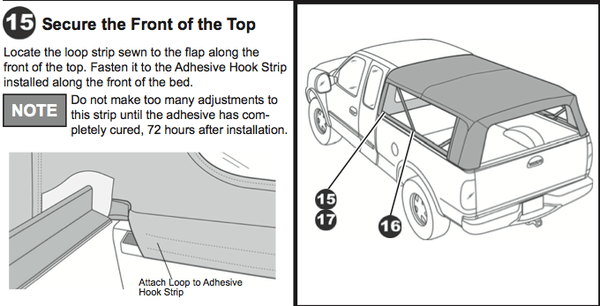

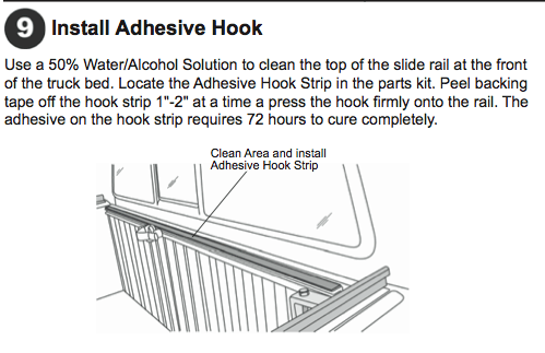

    Question to you Bestop guys...
    I got a Bestop off craigslist and it didn't come with the "Adhesive Hook Strip" that the front of the topper hangs onto (the piece that you tape onto the truck). I called Bestop and ordered two extra clamps that'll be put in the front. I didn't get the velcro because it would come out to ~$30. Will the two clamps in the front be sufficient enough to hold the front part of the topper? What does the Adhesive Hook Strip look like? Can I just get some industrial strength velcro with adhesive background and call it a day?
    Thanks in advanced

    I'm talking about this

    Yeah, you can go get some velcro at HD.

    My velcro strip didn't last long. I went to Lowes and got a piece of angle aluminum and have it clamped to the bulkhead.
