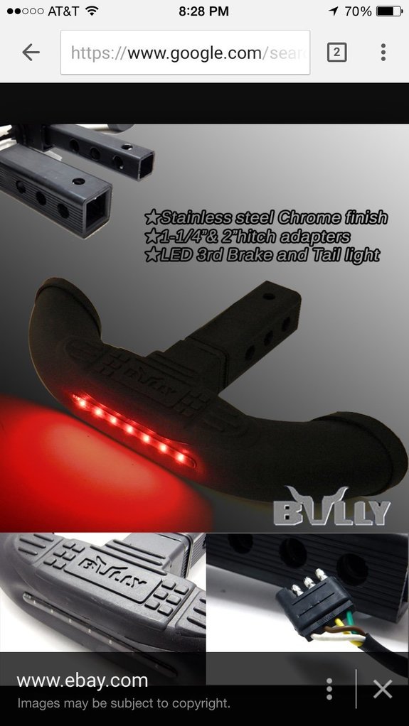

    What about putting one in your reciever/hitch?

    I wish - but I don't have a tow package. Otherwise looks cool. I was hoping I could plug the wires in near the brake lights without splicing and cutting but I'm not seeing any way to do so. I was also hoping there was a pass for pickups on the 3rd brake light law but that doesn' t seem too likely either. I did a fog light install but this one seems a lot stranger.
