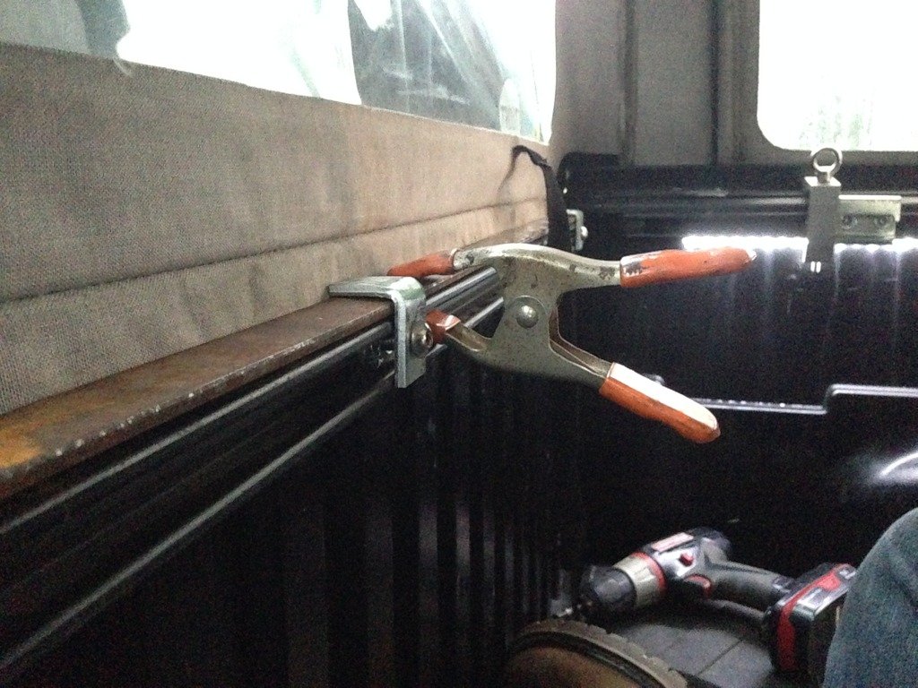

    Also like most, I have spring clamps holding the front flap to the OEM rail. Like so -

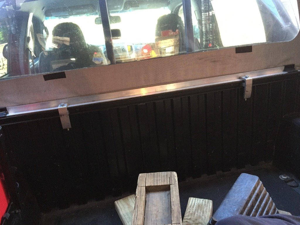

    I've since sold my Bestop, but I spent $25 for new camps and cut them so they fit better. First I tried spring clamps...
    I also spent a little extra and put some aluminum angle up front for the clamps to rest on.

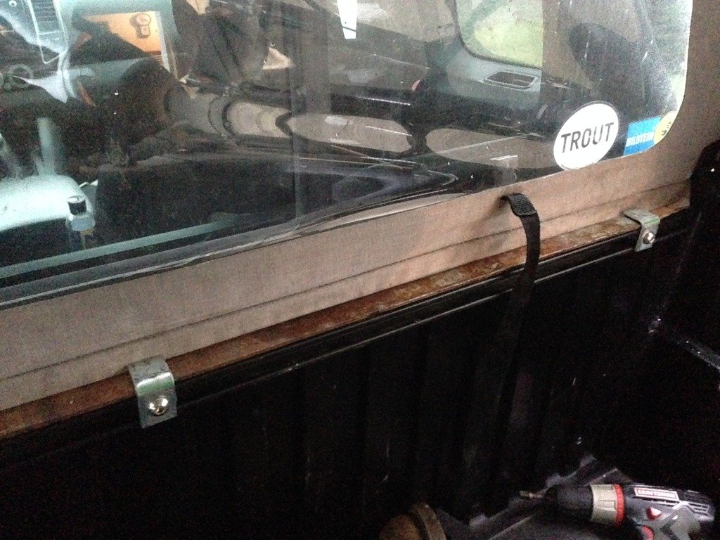

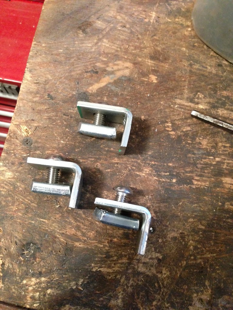

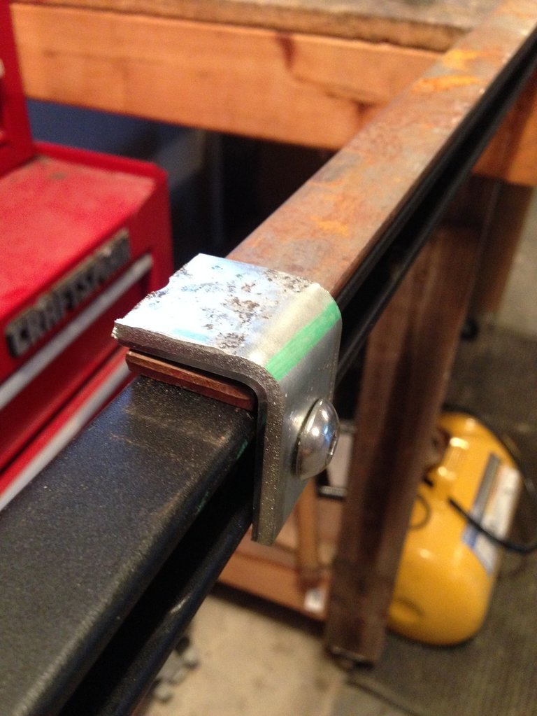

    I had some free time today, so I experimented with a design and I think its gonna work well.
    322D8BD7-29CC-49DE-91AE-59FAC74A4398_zps_4efbc0f7e93a656fd949672b8cd6550fa34885d7.jpg
    3/8" unistrut nut, flat stock bent to a 90*, and 3/8" button head bolts.

    Compared to the existing mounting system -
    7E798347-421F-4CE8-B33D-36B9413A7D3B_zps_89641b05901e63d4af34dca413dfa18dad366fbb.jpg
    Looks like its gonna work. One big plus is that these clamps are smaller than the Bestop clamps.
    Im gonna run them like this for a while, and if they continue to work, I'll pull everything apart and paint it.
