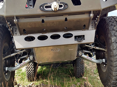

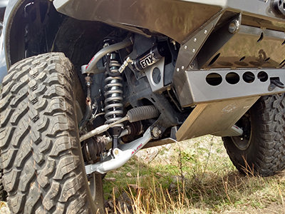

    All-Pro Long Travel is now on order :cool:
    It is their brand new High Clearance Long Travel Kit with boxed and plated lowers.
    Brownie2_zpsnag8x3a9_21015a1a91204bacbb08334b9b123762d39d86c4.jpg brownie1_zpsqdtx5prc_e0f54d3dffa3a7ed4f7d649abd97d944b952c183.jpg
    I will be doing a full install/write up thread once the process starts. :thumbsup:
    #staytuned

    Have fun with the axles.....

    And put limit straps on that kit

    Limit straps are ordered, axles shouldn't be to much of a burden. While I'm at it, im going to make 1 or 2 spares for the trail.

    Lol have you done LT axles before?

    cool they got rid of that really stupid lower shock bolt design

    Long travel axles are very easy, only PITA is the grease to deal with.

    Not always, you must of never had stubborn ones
