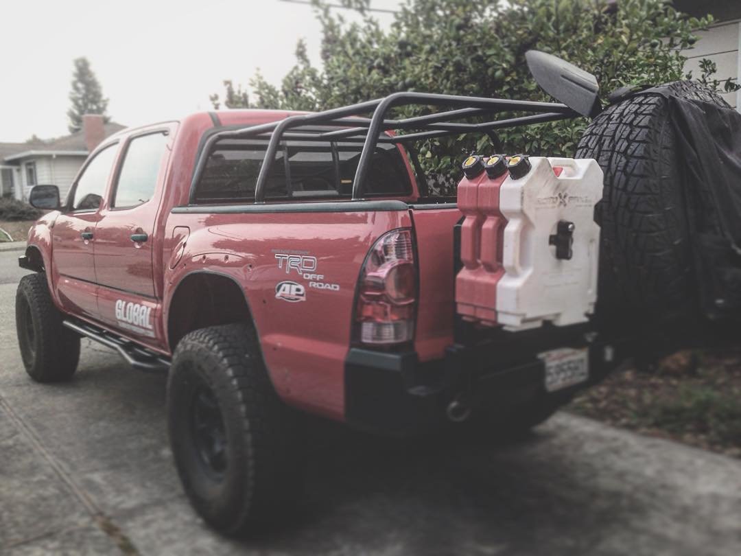

    Things are starting to happen around here again...
    - 35" Goodyear MTRs are on the way (5)
    - All-Pro Long Travel w/FOX Resi + Expo Springs w/FOX Resi will arrive next Tuesday
    - Got a spare CV so I can start to rebuild the CVs before the install
    - @Mademan925 will be driving up to lend a hand with the install the Saturday after Thanksgiving! (THANK YOU)
    - OTRATTW Switches on the way - Will be cleaning up some wiring when I install the rock lights.
    Should have this all complete and lined up before the xmas tree run on December 5th :woot:

    Why'd you go with AP over TC for their LT kits?

    It's all pros new version I think is what he's getting, that old version is JUNk

    So most people had issues with old version? Thats good to know... I'm looking into LT setups and just trying to get feedback on reasons people picked one over the other.

    I don't think that there old LT kit is junk by any means @Basikbiker @utroda it has proven it self off-road on thousands of vehicles.
    The new LT kit is boxed and actually has more ground clearance. I do like that they have relocated the shock mounts, and added limit straps to the new kit. I also like the integration between having tubed and boxed lowers - personally think it adds more strength.
    And have you seen the new kit this thing is sexy :cool:

    The old kit is a pile of junk and fits like shit, bad design. Having played with one of thier kits I know first hand, the new boxed design looks much better thought out.
    Tube design is because it's cheaper and easier to make, strength meh your not going to snap any well built aftermarket arm anyway.
