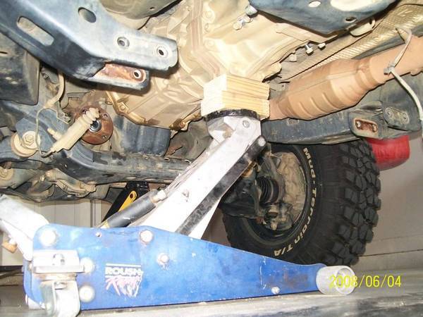

    I used this write up to do my clutch recently. Thank you to OP as this was truly a saving grace as this was my first time and I was doing it by myself.
    One suggestion I wanted to add to maybe help others. When I was attempting to get the transmission back up in (balancing it on 2 jacks) which was nearly impossible. To not get my face crushed in, I put 2 ratchet straps around the frame rails and ran them under the transmission, one up near the front and one in the back at the transfer case. This helped support the weight and keeps it from falling off the jacks as easy. It also gave me the added protection in case it did fall off the jack. It allowed me to jimmy the transmission back into place a little easier then jacks alone.. Obviously a proper trans jack would have probably solved this issue but the average DIY may not have one.. Just figured id share..

    With two people who pretty much know what they're doing I was able to use just one floor jack to lift the transmission into place without much trouble, just have one person manning the jack handle, other person balancing it, and make sure you have the jack right under the COG of the tranny to make life easy. Trick is once you have the input shaft lined up the jack man needs to do a wheelie with the jack and then pull the handle towards the rear of the truck to pivot the jack on it's rear wheels causing the front of the jack to move towards the front of the truck allowing you to get the shaft into the pilot bearing and seat the dowel pins. Then quickly thread in a couple bellhousing bolts, toss the cross member on ASAP to support the weight. Then you can relax, get the jack out of the way, and bolt the rest up at your leisure.
