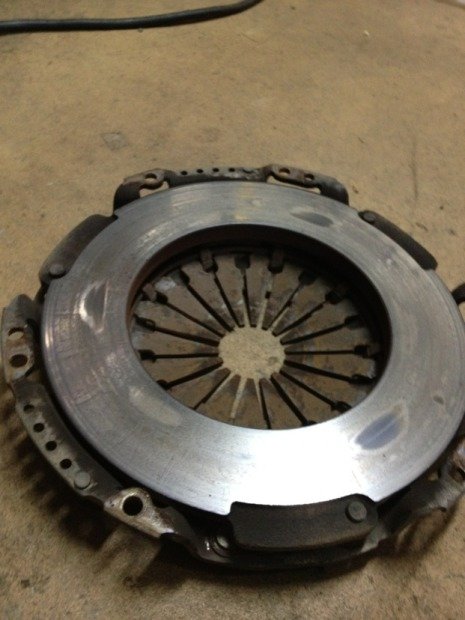

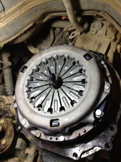

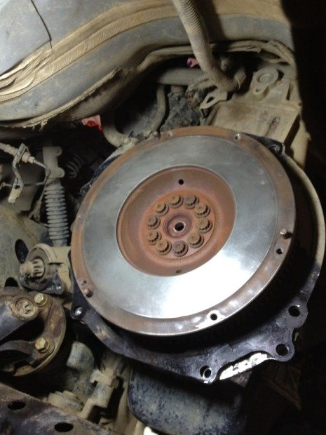

    after 140k
    216A44D4-9981-42E4-A1A6-6F5D7648B4EA_zps_1187a9d3c24332676282265062eb1da5b2fe1cb0.jpg
    C3656CA4-421C-4494-812E-6A6E865EBBB3_zps_d0841bf34ad14119bcea124e4e24094cd5003c67.jpg
    5843D746-1492-4B92-A54C-8B7D926AE13C_zps_5f9173f9d56d29e9167e6d9c04150c847c96d5a9.jpg
    IN WITH THE NEW :cool:

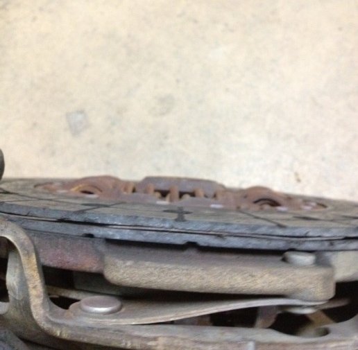

    i just updated the install with detail of pressure plate, pilot bearing and TOB unistall and install. I took all these pics a few months ago when i switched to the LCE dual comp clutch. Much better clutch for me then the Centerforce
