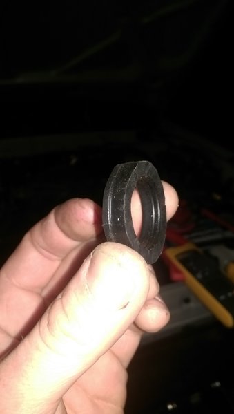

    I actually just did it this wkend. I recommend only going 3/8 to 1/2 Max. Which, if you cut the old boot's spacer dealio exactly in half + old c-clip will get you there.

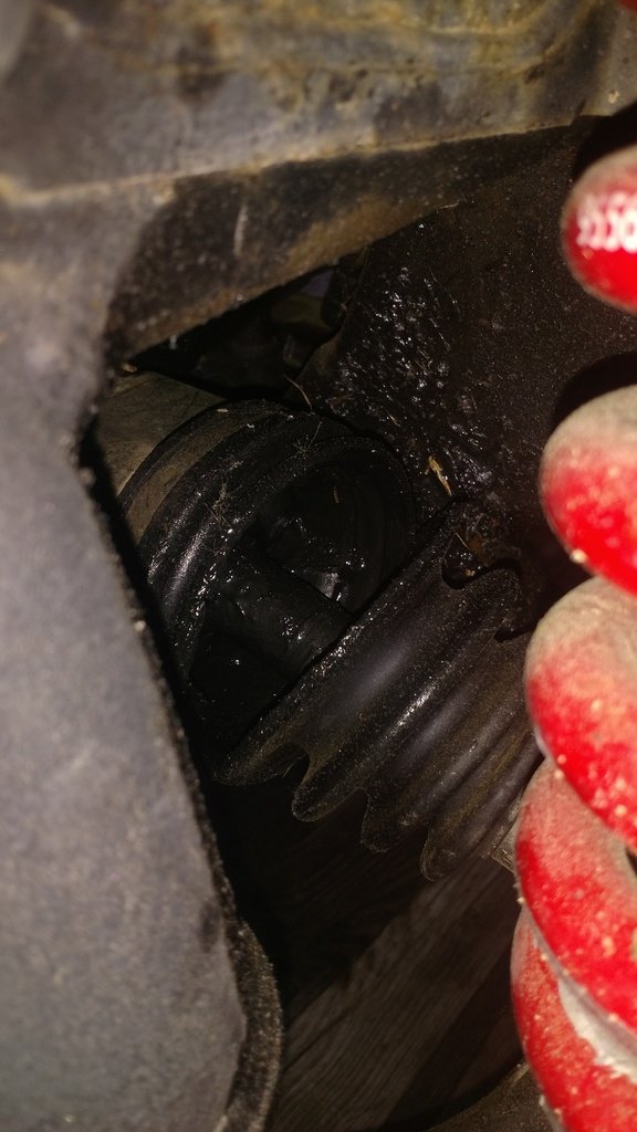

    This is inner boot at 3" of lift.

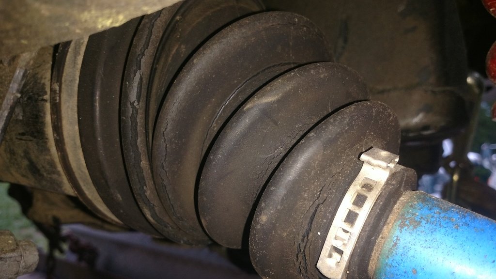

    My boots are not rubbing through, they are cracking on the inner most fin and breaking/ripping.

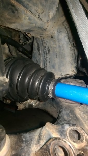

    Seems like I remember reading that the OSR boot don't need a clamp on the small end because it fits tighter, and will slide on the shaft.
    Here are my boots left side is split wide open.
