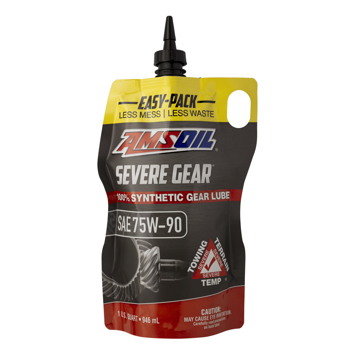

    These pouches work awesome, best thing to use IMO and I have used the pump many times. If you don't like Amsoil I believe you can buy just the pouches on Amazon or someplace.

    who makes a decent t case lube in squeeze pouches? I thought the full was something very special with limited compatibility ?
  12. Oct 23, 2023 at 9:04 AM
    BillyE
    BillyE Well-Known Member
    Nov 9, 2020
    #346277
    717
    Valvoline has the pouches too

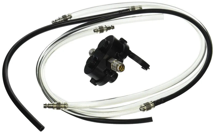

    SmoPo16
    SmoPo16 Active Member
    Mar 29, 2019
    #288378
    37
    East Central Illinois
    2019 Tacoma SR5

    That motive tool looks great. Unfortunately I do not have a robust compressor in the garage. Do you know if it will work without one?
  19. Oct 23, 2023 at 10:40 AM
    #19
    SmoPo16
    Mar 29, 2019
    #288378
    37
    2019 Tacoma SR5
    Yes, this tank can be pumped up just like a yard spray spray tank or an air compressor. I have always just pumped it up by hand.
