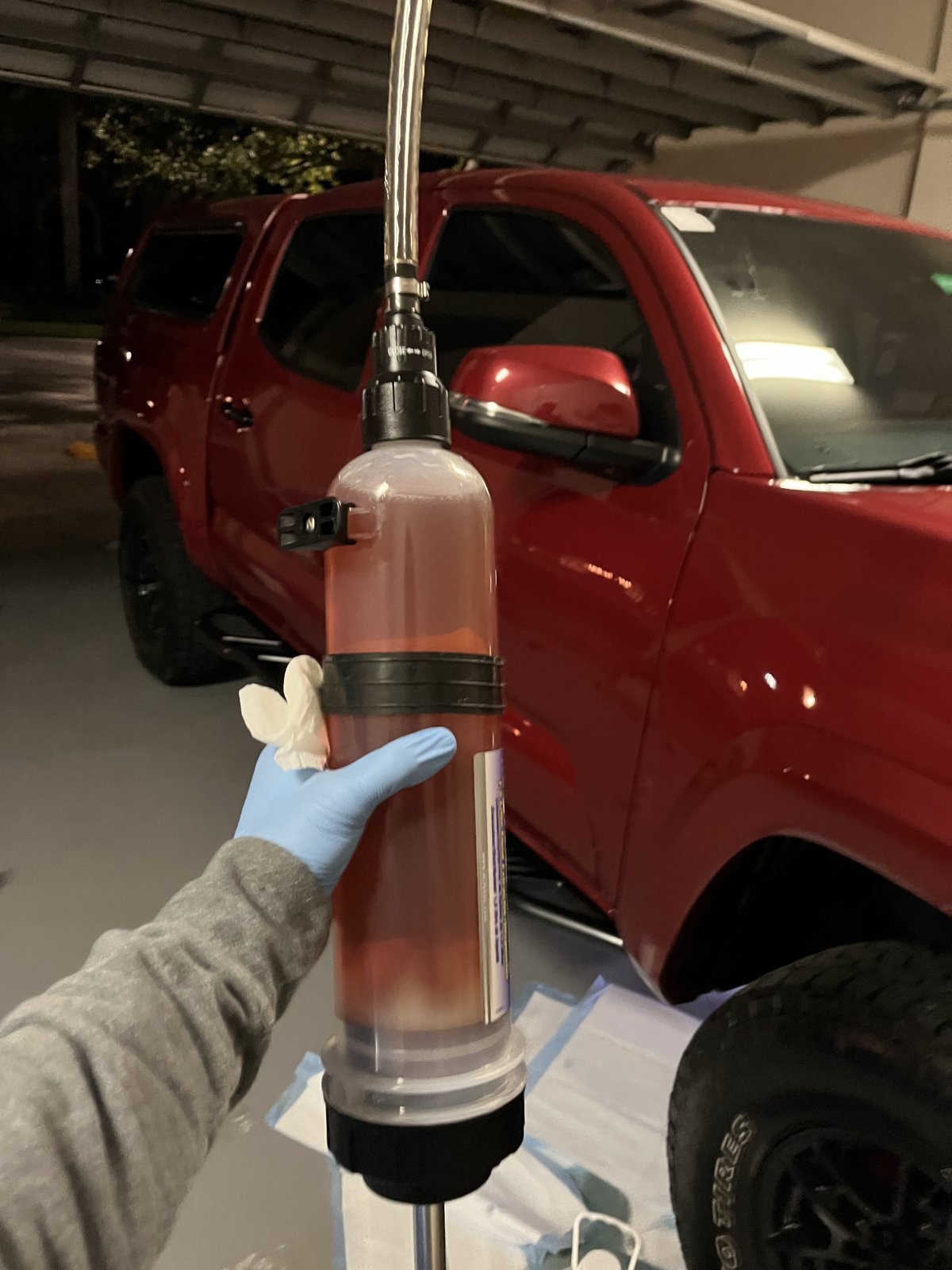

    Thanks again guys. Used this Mitivac syrynge to fill the MT. Looks like an injection! Took two syringes for the MT.
    biggest challenges are keeping the floor clean and getting out from under the truck and back again. Definitely need multiple fill devices for different fluids-two much of a PITA to clean.
    I am thinking : syringe for the MT (maybe two so you don’t need to refill), syrynge for T case (one shot will do it) and the motive pump for the diffs.
    now I just need a motorcycle jack to aid with skid plate r and I.
