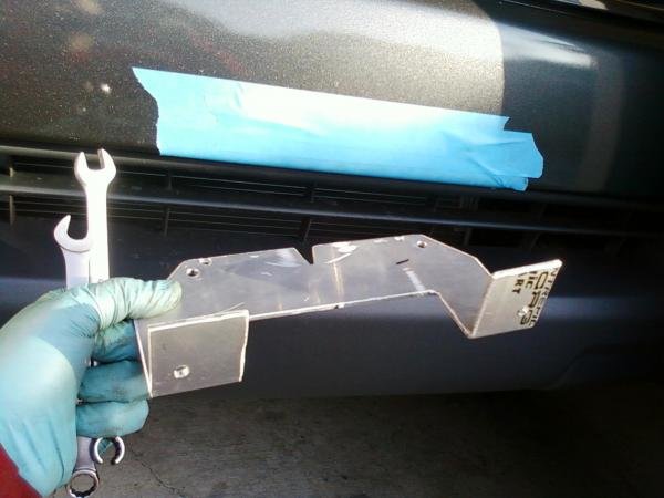

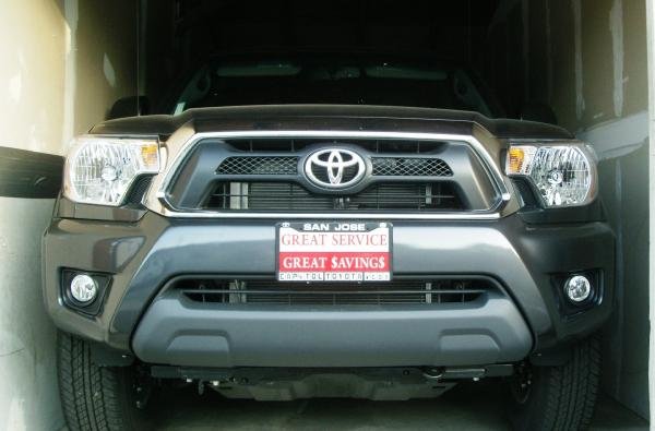

    Got my truck a few days ago and im already busy with custom fabs.
    this one just moved the lic plate up, making airflow to radiator better. the only holes i did are under the plastic, nothing in the front. Used scrap aluminum. Ill be making more custom pieces on this truck, welder fabricator here...

    Wow OP, im amazed at how tight of a spot you got that truck in!
    Plate relocation looks good IMO.

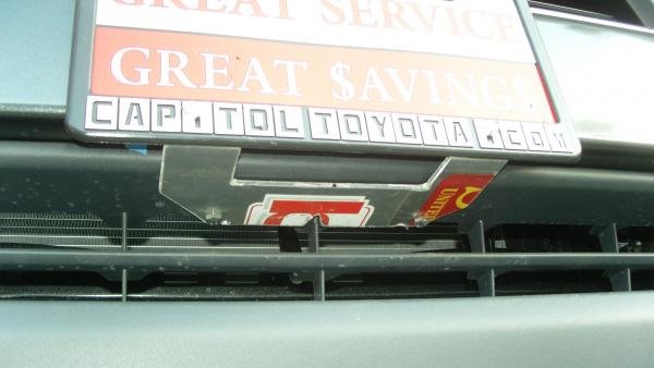

    Did you have to drill holes for those bolts you mounted to the bumper?
  14. Jul 6, 2015 at 12:57 PM
    jrubicon
    jrubicon [OP] Well-Known Member
    Apr 26, 2013
    #102941
    54
    Jason
    Santa Clara, Earth
    2013 KRTHALR
    yes, if you look closely at the 3rd picture from the top, from pic of truck form dealer, you can see 2 6 mm bolts.
    Its impossible to drill since nothing will fit in that small of a space,
    so i use a allen wrench, L shaped, with a vice grip on one end, and a candle on the other to heat the allen wrench.
    melted a hole.
    the allen wrench provides a way to get it in there and melt a hole for bolt
