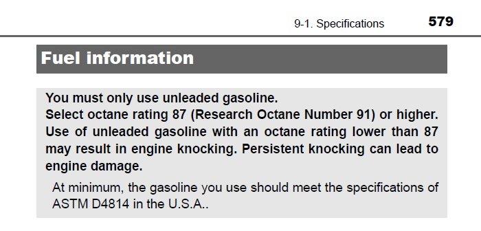

    So what does your Toyota owner's manual specify as far as octane rating? Pretty sure they did high altitude testing... I don't see 85 anywhere in my manual, except as a page number.

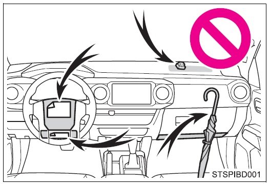

    Did you know your manual also says:
    * Obey the legal speed limit.
    * Never install seat covers.
    * Do not use control knobs while driving. Do you have manual hvac? Too cold? Too bad. Do not touch that dial until you've come to a complete stop.
    * Do not read while driving---does that include the speedometer? They didn't specify.
    * Do not talk on the phone while driving. Glad they made doing that so easy.
    * Do not carry umbrellas.
    Guess some people need a manual to tell them what to do.

    Manual says 87 octane.
    It also says my kettle boils water at 212°F, but that’s not what my thermometer reads (and it ain’t broke).
    FFS, stop with the coy nonsense. If you don’t understand atmospheric pressure, please don’t speak about it.
