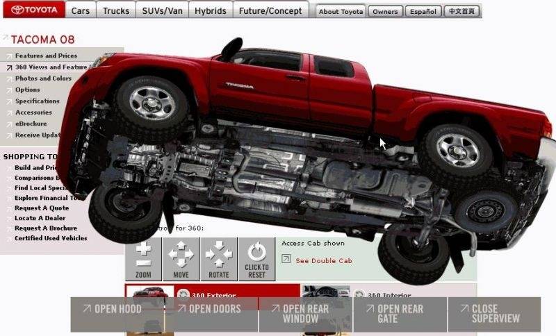

    I just realized something. I couldn't figure out why some of my gas mileage was so erratic. Sometimes I got phenominal gas mileage and other times I would get crap gas mileage. I was trying to think of what would cause such a difference even on consistent tanks.
    The answer: not filling the tank all the way. I know what you're thinking, "...but I top off the tank every time?!" I know I do, but I noticed last night when I filled up my wife's RAV4 that the gas pumps are on an incline. (Picture coming soon) As you can see from the snapshot below, the filler cap on the Tacoma is towards the rear of the tank. This is true for both AccessCab and DoubleCab Tacomas. Don't believe me? Check this out. This means that anytime you fill up with your truck pointed up hill, you will have an air pocket form in your tank, and you won't get an accurate MPG reading.
    http://www.toyota.com/vehicles/2008/tacoma/key_features/ext360.html
    So now I feel a little embarrased, AND I have to start this test all over starting today. I apologize to those of you that have been following this thread closely. I will be testing the ECO-1 based on Mon-Fri commuting and in-town driving on a tank that is filled the same way everytime (filler cap on the up-hill side).

    Mark,
    In regards to your last post about filling station angle. At first glance I agreed with you, but as I thought about it a little more while setting up the sprinklers to water the new grass seed (honey-do list item) I think that is not the case.
    While the incline of the pumps could account for why tank A enabled you to drive 400 miles before the light came on and tank B enabled you to only drive 350 miles before the light came on. It should not change you overall average mileage that much. Here's my thinking, it is not like you pumped gas into that air space, so if when the needle is on E the truck takes 18 gallons to fill, and you were facing up-hill, then that day it probably only took 17 gallons before the pump kicked off, so supposing that you had a gallon of air space in the tank, and you get an average of 21 MPG, then we are only talking about a 1.1 MPG swing here. Conversely, if you filled up nose down on tank 1, and then nose up on tank 2 then the mileage calculation for tank one should be 1.1 MPG higher since it would not have pumped as much fuel as you really used.
    Then in the end for the final report, as long as we average all like tanks, say running solo, hauling, and towing, then the 1.1MPG swing should cancel itself out.
    So as far as I can tell your best bet will still be to use the same grade gas from the same station as often as possible, as that big mileage swing that you experienced last weekend is still most likely the result of bad gas.
    As far as the final report goes, I'd say you can still include towing and hauling information, (though I'd exclude last weekend's bad gas tanks) and simply make a note that the load varried greatly, so people should make the decision to purchase based on your running solo numbers. While my towing numbers should remain fairly consistant as the RV pretty much weighs the same every trip out.
    What do you think?

    I agree with you on 99% of it. However, I think the discrepancy is more along the lines of 1.5-2 gallons difference based on incline.
    The tank from last week (solo Sept 9-14) didn't seem to fill all the way up. Usually the needle on my fuel gauge does not begin to drop from F (completely full) until I hit 63 miles on the odometer. On the tank in question, it began to drop after only 20 miles on the odo. At a horrible average of 19 MPG (let's say it was 20 accounting for error in fueling) - I lost 2 gallons right off the bat. :(
    Combine the "not filling up" scenario with the poor fuel quality issue, and that is probably how I ended up at 19 MPG with an empty truck. That is just plain crazy on a 2.7L.
    I agree with you. I think that it is a minimal difference, but Ben has a point. We need to compare apples to apples. I need to make sure that I have at least three consistent tanks for comparison. As of now, I don't have two that are alike (driving style and other conditions).

    i'd think that either way u cut it....if u put in 18.7 gallons when u fill up, then u ran 18.7 gallons out of the truck...use that number and divide ur mileage by it. if u had an air pocket and it only let u put in 17.3 gallons the next time, then divide ur lower mileage by that 17.3...right?
