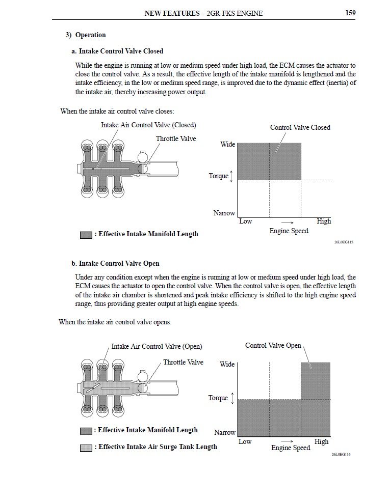

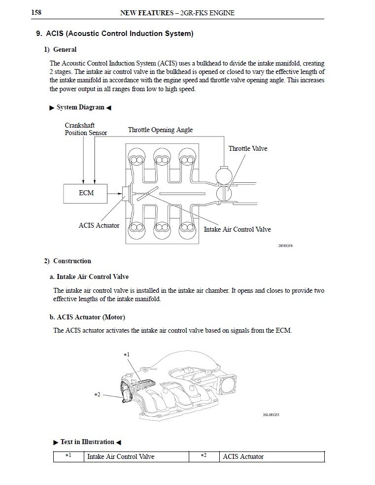

    2GR-FKS intake shenanigans (it's actually bipolar, just like the auto trans :D):
    Thread completely jacked. I have no idea if the Camry and/or IS 350 share this magic intake. Because I don't.. care?
