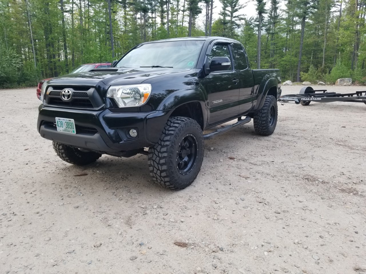

    I went with an OME setup from headstrong on LT285/75/r17s. also included SPC UCAs. They didn't add that much to the price.
