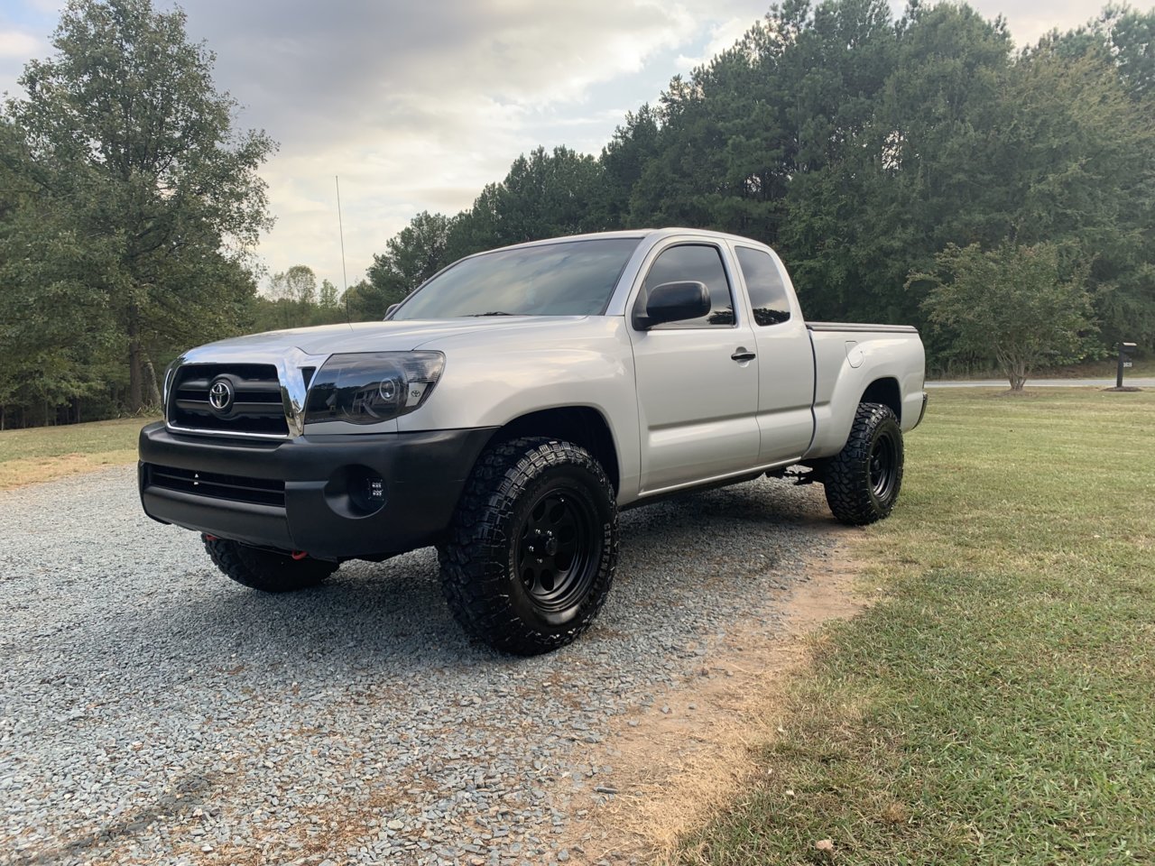

    Have a slightly lifted 5 lug. 2” lift rear billy 5100’s ride like a wagon. Would 4600’s be better suited for me since my truck is lighter. Nothing in the bed. No armor none of that. Just want a smoother ride. Ass seems stiff, suggestions??

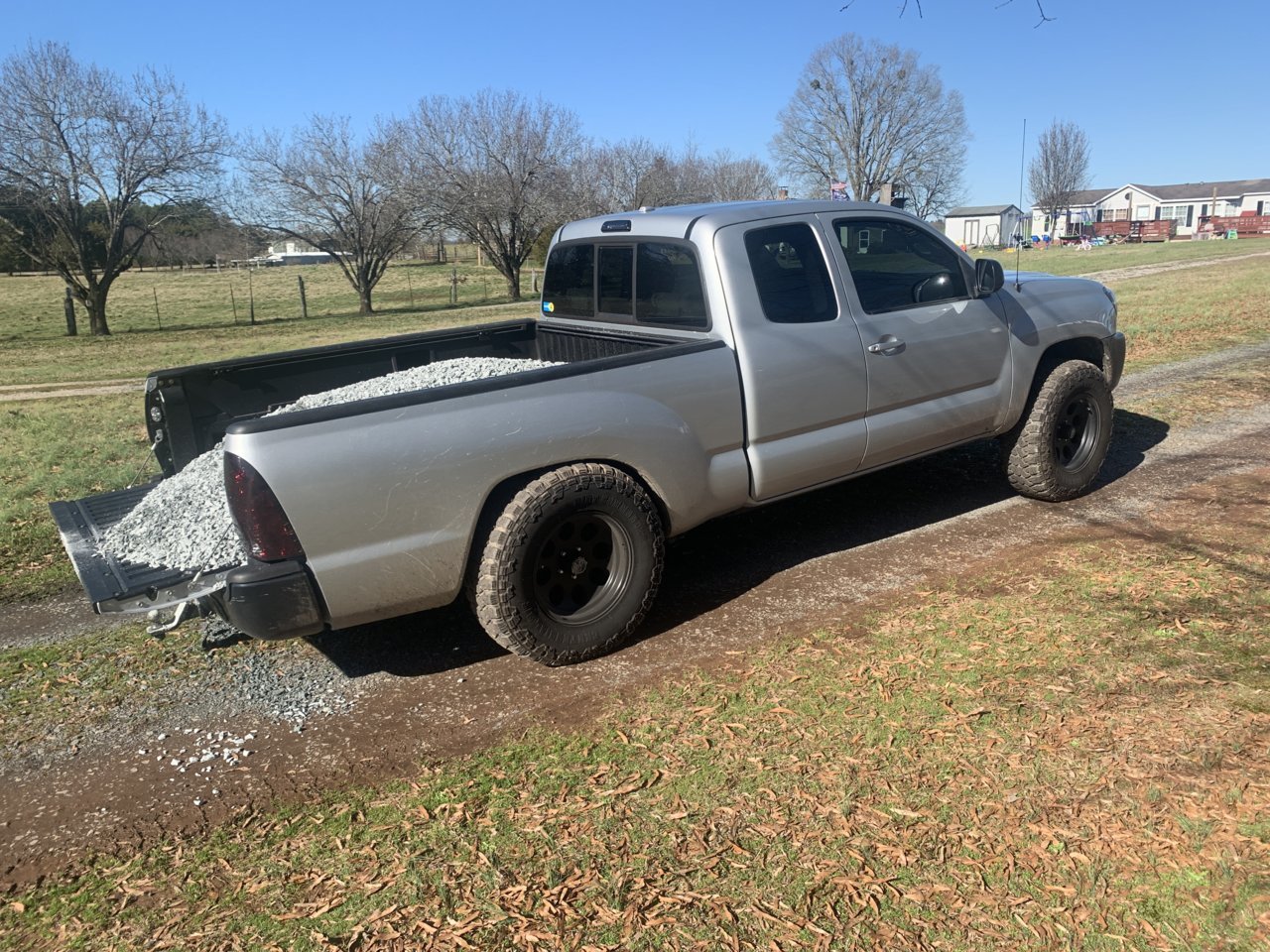

    Your leafs are the bigger constraint in the rear. Throw auntie sherryl back there and see if it rides better

    Loaded it down with gravel which I figured would break the shocks and add a leaf in and soften things up. No dice
