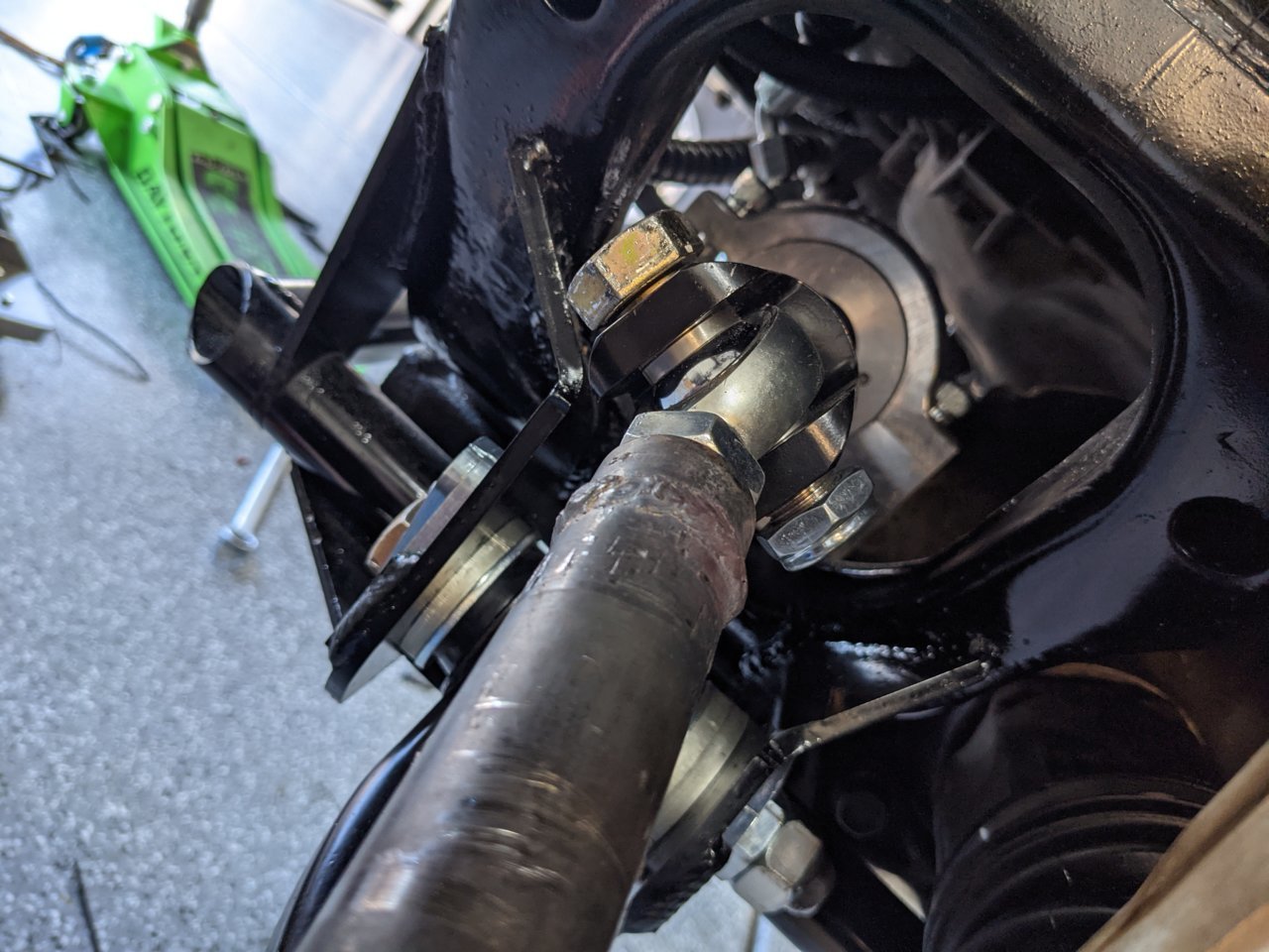

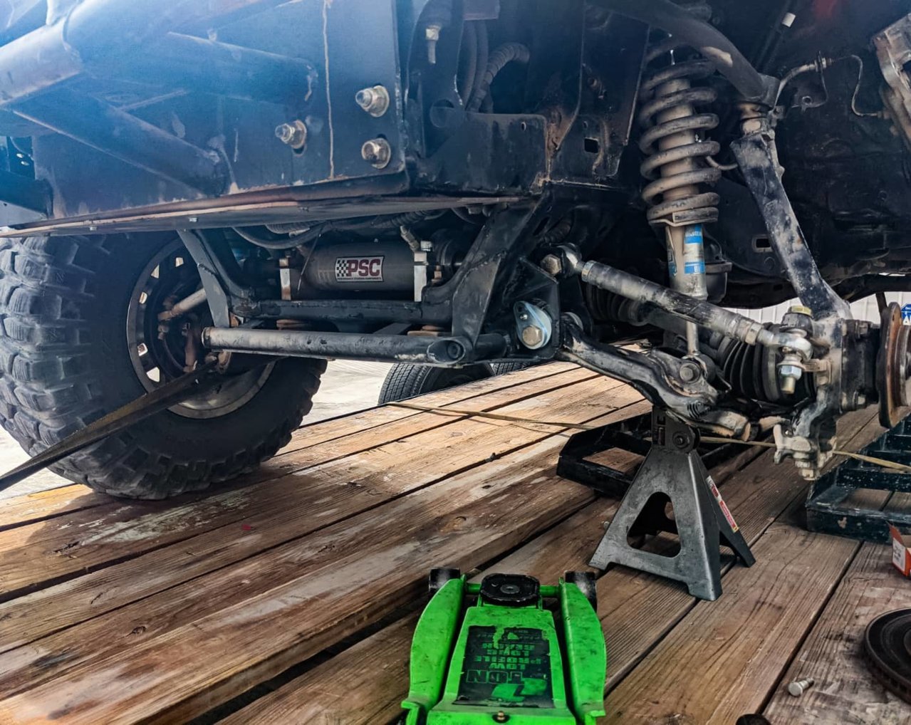

  7. Feb 18, 2022 at 7:05 AM
    #27
    BEAR_KNIFE_FIGHT
    BEAR_KNIFE_FIGHT [OP] bearly famous
    May 21, 2016
    #187524
    2,586
    Alex
    Minnesota
    2016 TRD OR 4X4 DCSB Slowsand, 2017 WRX WRB
    3rd Gen full heim tierods - stock tacoma rack

    Full hydro.
    It has its downsides, but its probably the strongest setup youll find.
