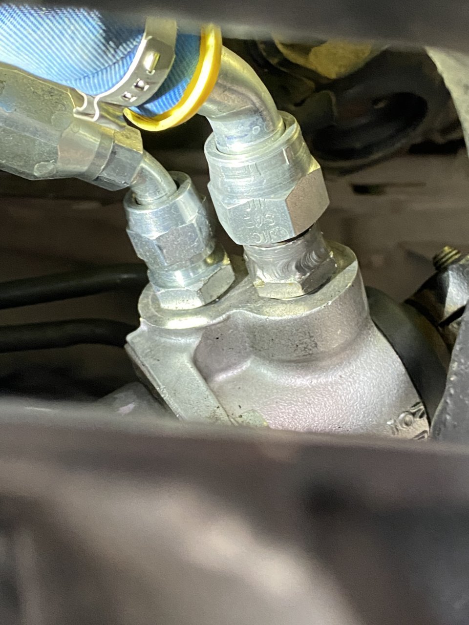

    Its not a factory tube. Looks as if its a bubble flare union cut in half and a an fitting tig welded to it. Heres a pic of mine

    I may be mistaken but I'm pretty sure they switched tactics and no longer use a custom fitting. The high pressure feed line appeared to be an off the shelf adapter. The return fitting is now just a barbed fitting and you reuse your stock return connection and a few inches of hose coming out of the rack and then marry it to new hose they supply. That was the case for my recent install of the kit.
    With that said @Tac05 their kit is 100% worth it. It's so nice having everything there on hand ready to bolt up. No need to figure out the correct belt length or anything, it simply just works. It's a ridiculously nice difference especially when paired with a larger rack (I have the tundra rack).

    You can see what I'm talking about here. Also a pic of the high pressure adapter. Originally I received the wrong one and Harry was quick to remedy it, even while sick. He overnighted me the correct one.

    Interesting. I didnt know you could just buy the adapter. That makes it alot easier for someone to piece together thier own kit for half the price.
    The stock belt should fit with the stock pulley. And my psc and trail gear TC style pumps both fit the stock pulley.
