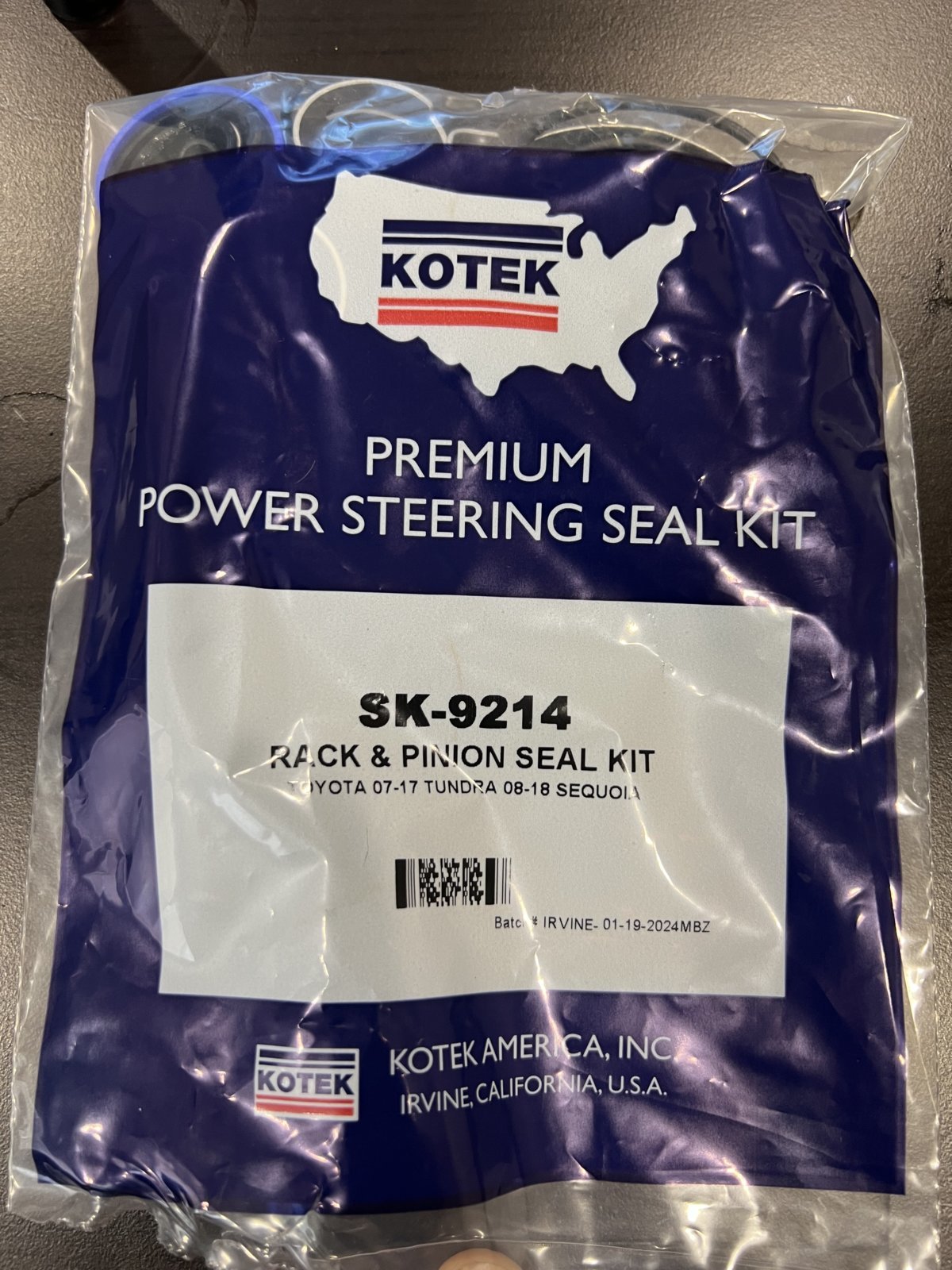

    FYI doing a seal kit on a tundra rack is very straight forward and easy. Here’s the seal kit I used costs about $30, I’d definitely keep one on hand if you've upgraded to a tundra steering rack.

    Where are you buying it from?

    It really doesn’t matter, anywhere online. As long as it for a 2007 or newer tundra, summit racing has the lowest prices Amazon has them more expensive but faster shipping.
    https://www.summitracing.com/parts/sug-8401557
