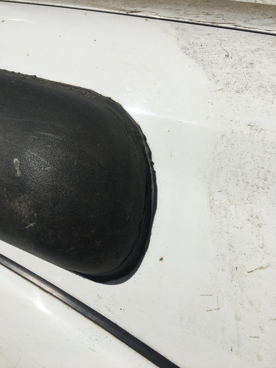

    Any chance of getting that closer pic of the front of the snorkel where you used the gasket material? Thanks

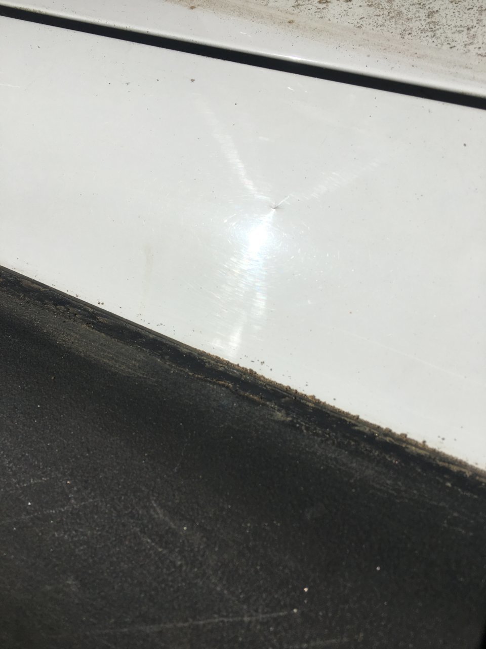

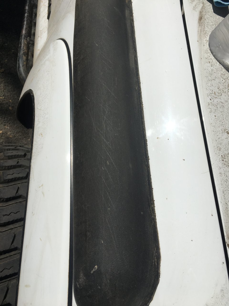

    So sorry for not getting back to you sooner! I snapped some pics a while back, let me know if you want some more I'd be happy to take some and I'll get back to you sooner this time.
    This was my first time using this stuff for something like this, and as such I made some mistakes that you can learn from! So I taped out an outline of the snorkel before I did it and that worked great, the only problem was that I let the FIPG sit too long before removing the tape, and thus ended up with a bit of an unclean line, since its more viscous. On the bottom, I took it off right away and ended up with a really clean line, hopefully you can tell from the pictures.
    Also sorry for the dirt.

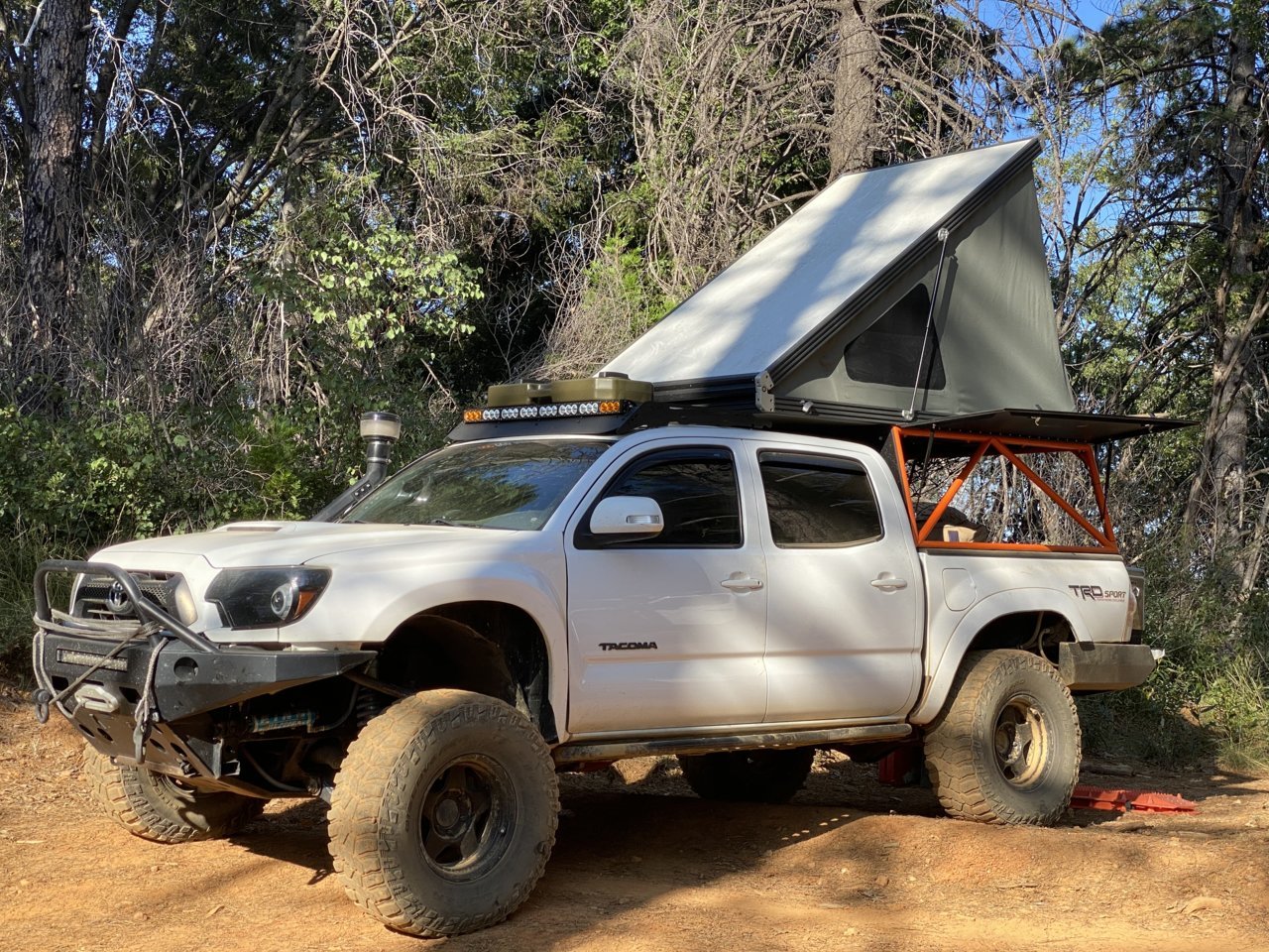

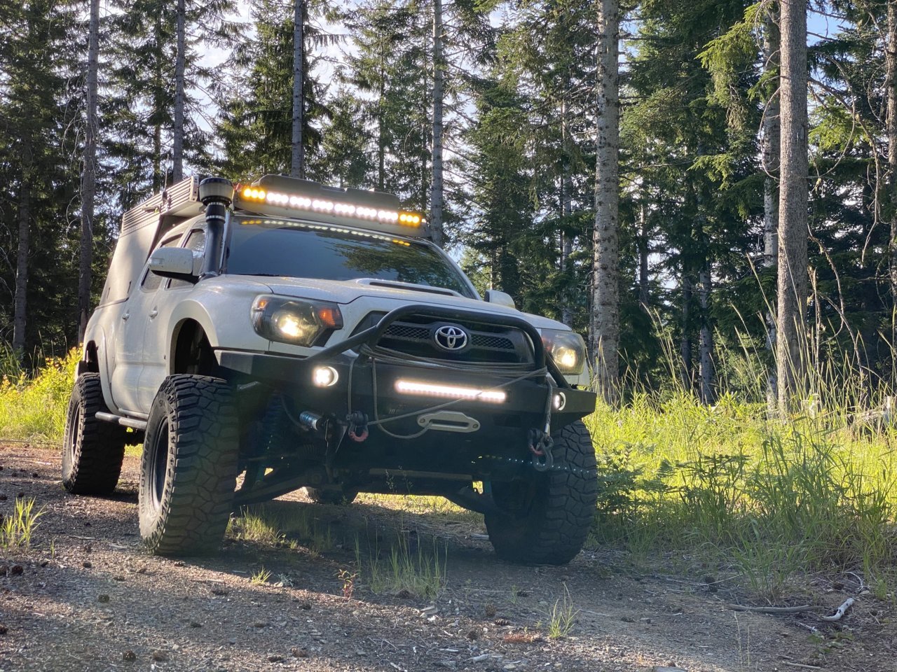

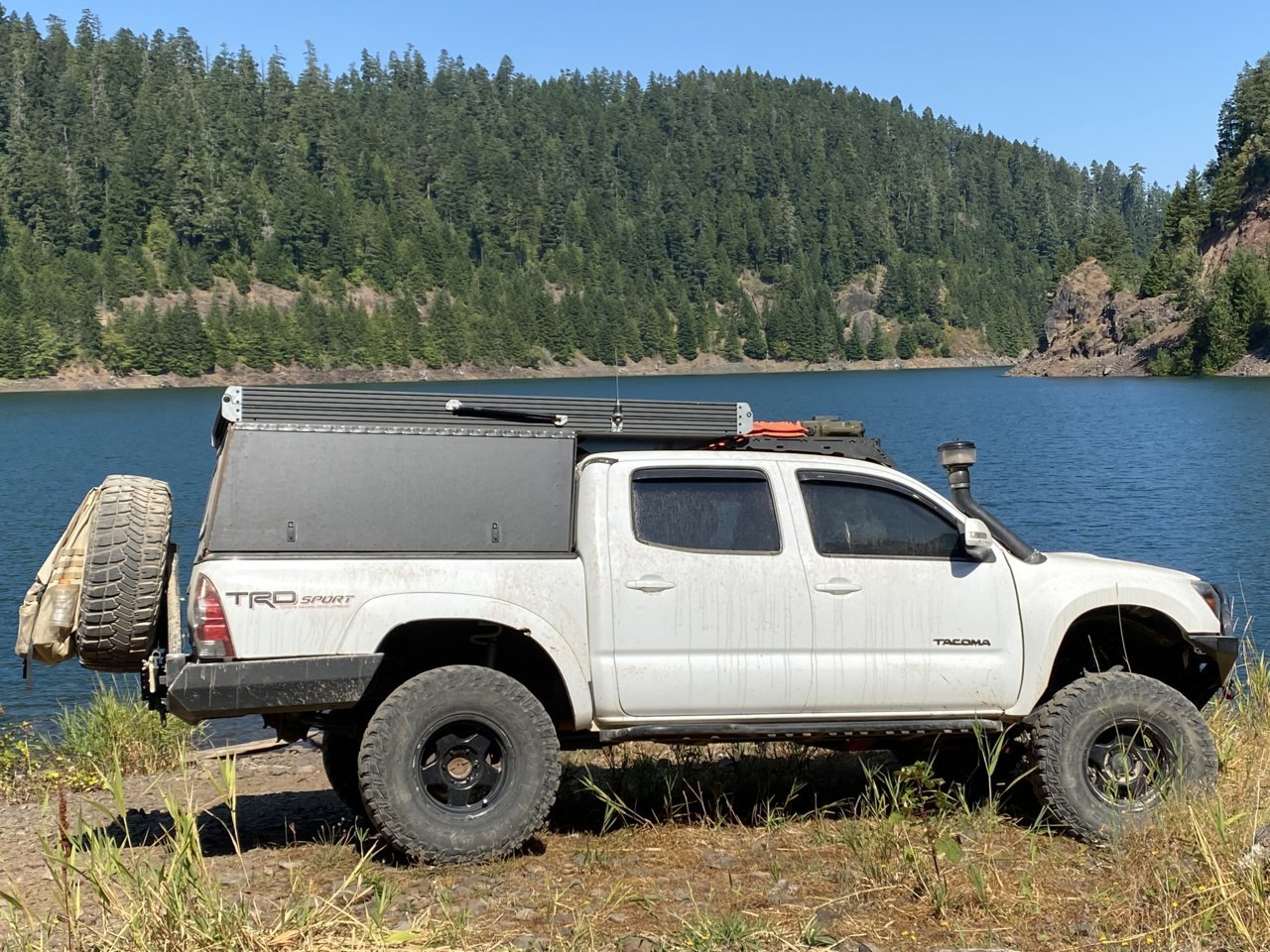

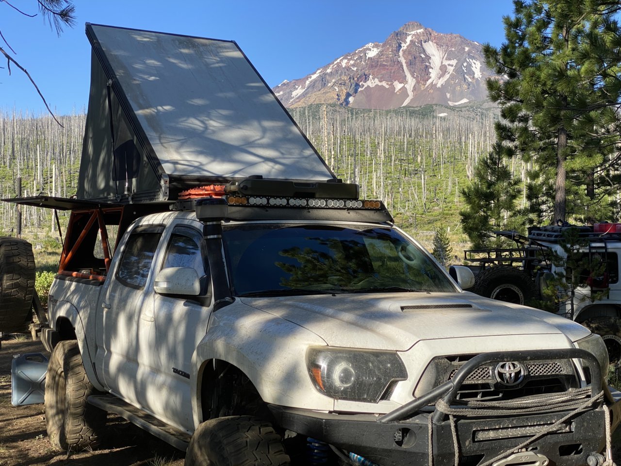

    Haven't kept this build thread up but it's a great place to document things as I do them, so I would like to post a bit more.
    Just got back from 10 days in the Oregon backcountry weaving together some trails from the Pacific Crest Overland Route (PCOR) and Oregon Backcountry Discovery Route (OBDR). Here's some of the best pictures of the truck.
    Got the break-in the GFC, the new roofrack, the snorkel, as well as the custom on-board hot water system I built.
