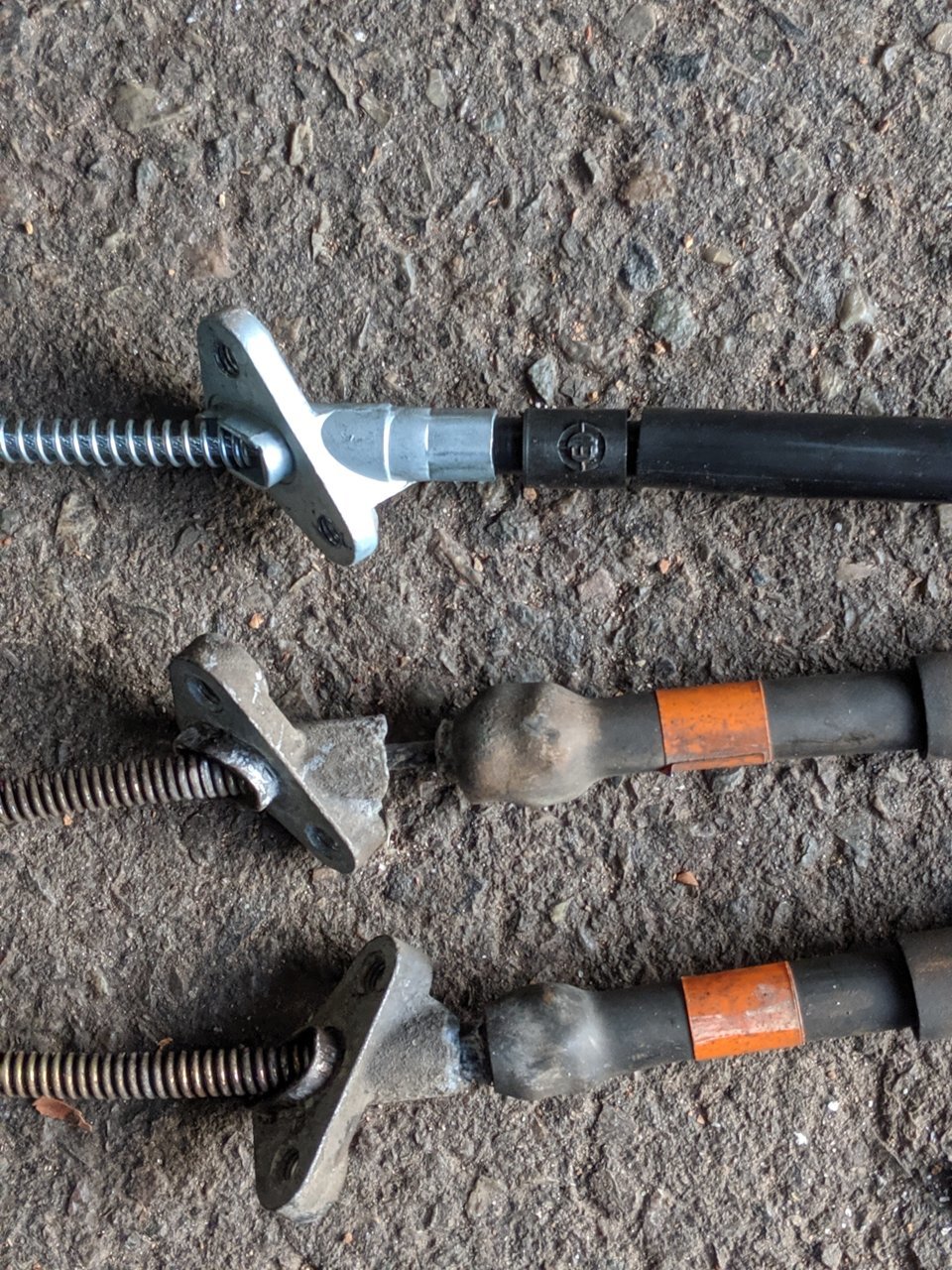

    Got a set of duralast Ebrake cables for my '06 dclb. They were less than half the price of the OEM cables and I got to use up a couple gift cards the kids got me.
    I should have gone OEM. :smack:<<< do you know how hard that is to do to yourself?
    The cable for the drivers side was to short. The insulation for the passenger side cable is a joke compared to oem where it traverses the exhaust. Looks like the OEM cable itself is jacketed in the sheath, or outer jacket. Aftermarket is just the bare cable in the jacket.
    All the listings at several stores nearby have the wrong length cable spec'd for the drivers side.
    My old cables have an orange band at the drum end of the cable. One of the new ones did as well. The short one, had a black band.IMG_20191123_154736.jpg

    My complaint is that all configurations call for the same cable for the drivers side in their catalogs. 2dr, AC, dc long and short bed.
    The cable assembly that was the correct length is installed as I needed it. However, they only give it a 90 day warranty, so they know it's not going to last long.
    Think cheap bicycle brake type cable and jacket. If the actual cable had a coating on it, I think it would be ok. This one is gonna rust inside the jacket

    10 pages searching "Toyota Tacoma parking brake cable" one relevant result. Dorman. The pic looked just like what I had. It did not however have a pic with the orange band.
    Looks like we both need a better source...

    What's your complaint about Dorman?
    Its not like it could be any worse than what came OEM. Your pictures prove that.

    So, I bought myself the raybestos cables for Christmas and the quality is outstanding compared to compared to the duralast cables.
    They came with all but 2 mounting clamps that were easily removed from the original cables. They were even marked L,R on the drum end. The cable itself is jacketed so it won't rust in the sheath anytime soon.
    They were less expensive than the duralast by almost 1/2. That made me leary, but I took the shot and it paid off.
