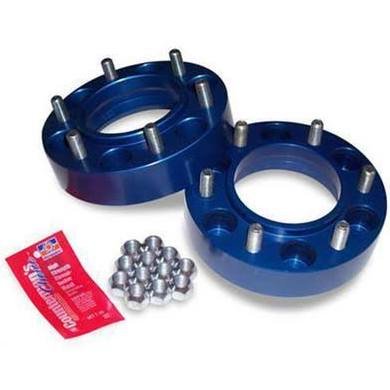

    Look up the member here that used an impact gun and broke aftermarket lug nuts on wheel spacers.
    He was drilling for a couple days.
    Don’t use aftermarket lugs or an impact gun, unless you know what you’re doing.

    how do you run aftermarket wheels then lmfao

    I thought he used the wrong locktite plus over torqued them which resulted in end result. 100 percent user error cause lots of people run spacers with no issues
