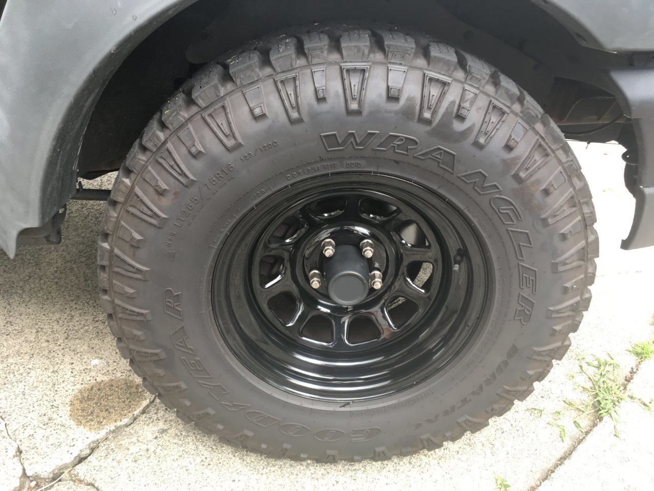

    8CFA3867-3128-4B2C-85DE-7EBA363BB52E.jpg Not very good lighting conditions, but you can see the weights on the upper inside of the rim. You are so right, beefy tires require a few more weights.
