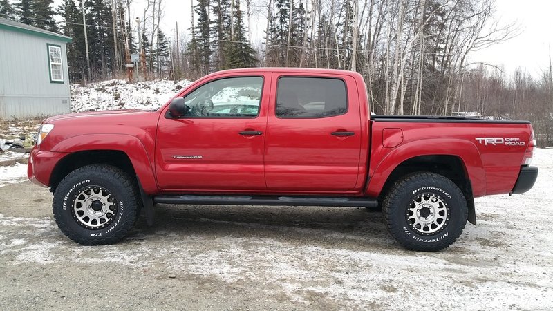

    20160122_145439.jpg I've got the KO2s and love them, good traction in snow and they are quiet.

    What lift is that?

    Those wheels are out the but I kinda like em

    Lift and tire size?

    Just got Bilstien 5100s set at 1.75inch in the front and also got the 5100s in the rear with a 1.5inch toytec add a leaf.
    265/75/R16 tires, I didn't want to deal with the rubbing issues and didn't want to loose too much MPGs considering I commute a lot so just went one size up. So far I'm averaging 18-19mpg with the heavier tires. I can live with that.
    Wheels are 16x8 0mm +offset Method NVs.

    Just bought BFG AT KO2's....best looking tire out there...very quiet on hiways, makes handling more securely....lost 1-2 mpg's due to weight....handle very well in rain..SO much better then original Rugged Trails that came from factory(got over 51,000 miles from them!)....really like httuner's Method Wheels...so bad-ass!
