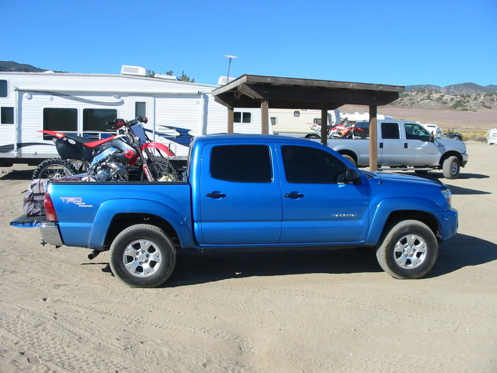

    MT classic 17x9 w/ BFG A/T 285/70-17. 5100's all around. Front set at 2.5 and 1.5 toytec aal. Little trimming, not too bad. Has not bottomed out even with 3 bikes in the back. would bottom out with stock setup and 1 bike too often.

    Well I think you've made my decision... And about the 1 bike in the back bottoming out... I FEEL THE PAIN!!! trust me... twice a week to the track. I couldnt believe it was doing that... haha. That Really is a nice setup you have there.
    Do you have the stock coils? in the front?

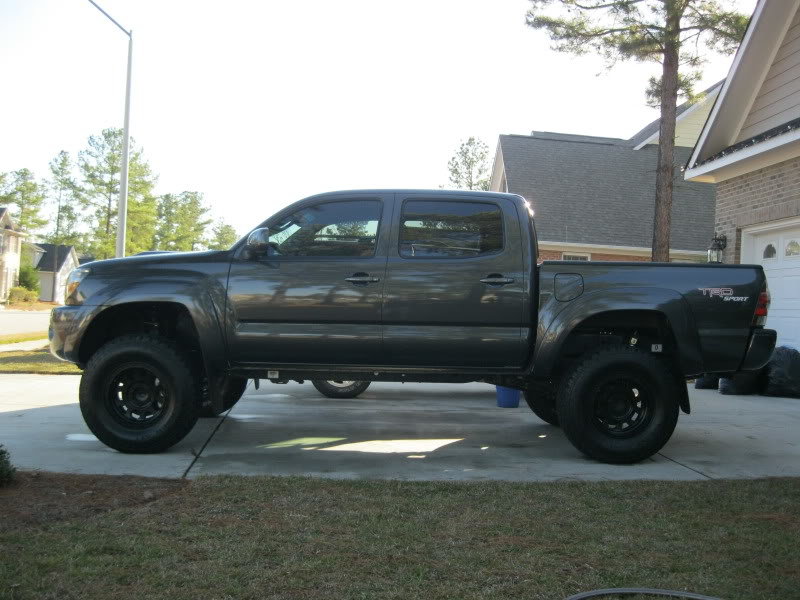

    I agree w/the poster above - go 16s if they'll fit - the bigger tires will look better in my opinion. IMG_0153_68ac46ef7ce0f21a42bf315a56a16cfb11396e69.jpg

    Yeah stock coils. Did it about 3 years ago and wouldn't change a thing. Little stiff on the street but nothing like my dads corvette. Drives great on dirt roads. Gorman I-5 road into track and ohv area is a blast haulin ass down. Accidentally jumped it, just a little, a few months ago up there on the main road. Took it really well. Totally not on purpose and won't do it again. ;)
