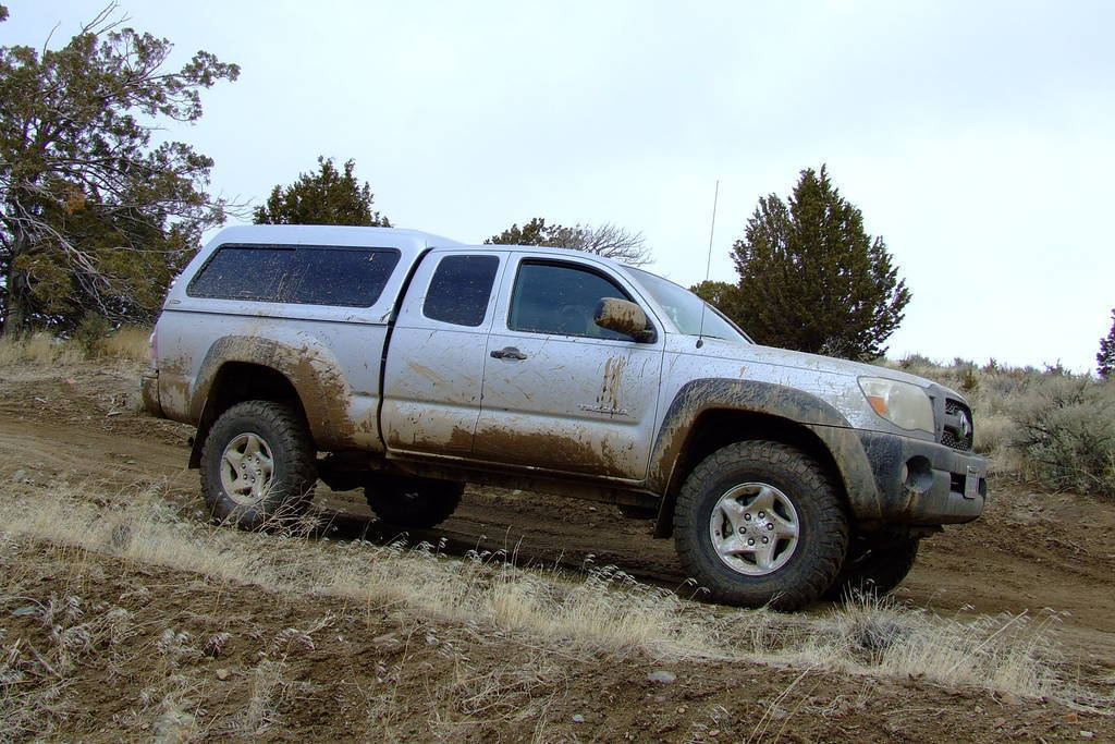

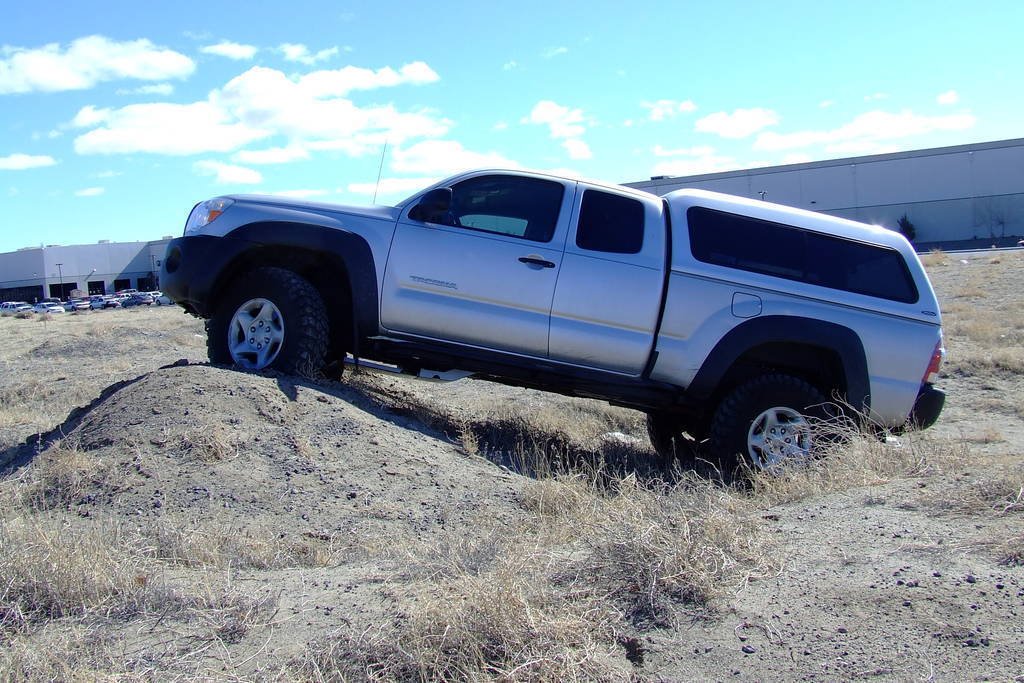

    I went with 255/85/16 BFG KM2s on my 4Banger.
    Mileage varies from -2 to +2 from average with stock tires depending on hilly or flat hwy (10% more mileage than Odo shows according to my GPS). I don't know what I'm getting since adding sliders & a full set of skids. Lift needed for this size but 265/75/16s will work stock.

    255 look is really growing on me. I might run them next year. How do you like them?

    They are great. My little 4Banger lead the way up a mountain for some locked V6s the last weekend of the year plowing snow up to 2' deep. It was the first time I ever spun them, but I wasn't aired down (every one was spinning)
    Pine Grove Mines Snow Wheeling Picture Thread 12/29/12
    And last spring while the 265s & 285s were slipping & sliding in the mud my 255s cut right through it.
    Cold Spring Trenches & Dog Valley 3/18/12 (First off road in mud & snow)
