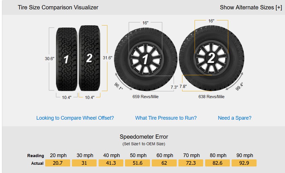

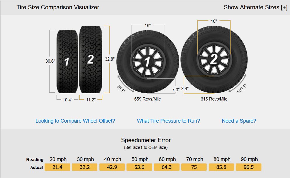

    I've seen the explanation of skinny vs wide and how skinny actually works better. Problem is that I'm 265/70-16 and going to a 75 is about my only option in 16s. Would love to see a BFG in an 80 series. To get taller than 265/75-16, I have to go wider too.
    265/70 vs 265/75 - 1" overall equates to roughly 0.5" taller.
    265/70 vs 285/75 - 2.2" larger than stock and 1" of ground clearance.
    265/80 would be 2.1" taller than stock. So I could have the height w/o as much weight slung around that wheel.

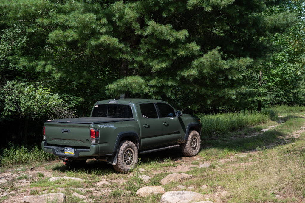

    Excellent Vid! And that's a great endorsement. Looks like the kind of driving and terrain I encounter out here 2000 miles away (assuming those were Pennsylvania Plates?)
    Like the mudflaps too. Very Classic.

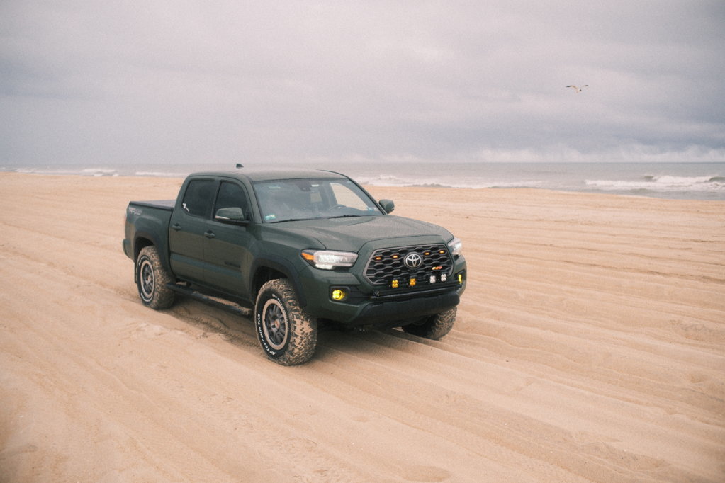

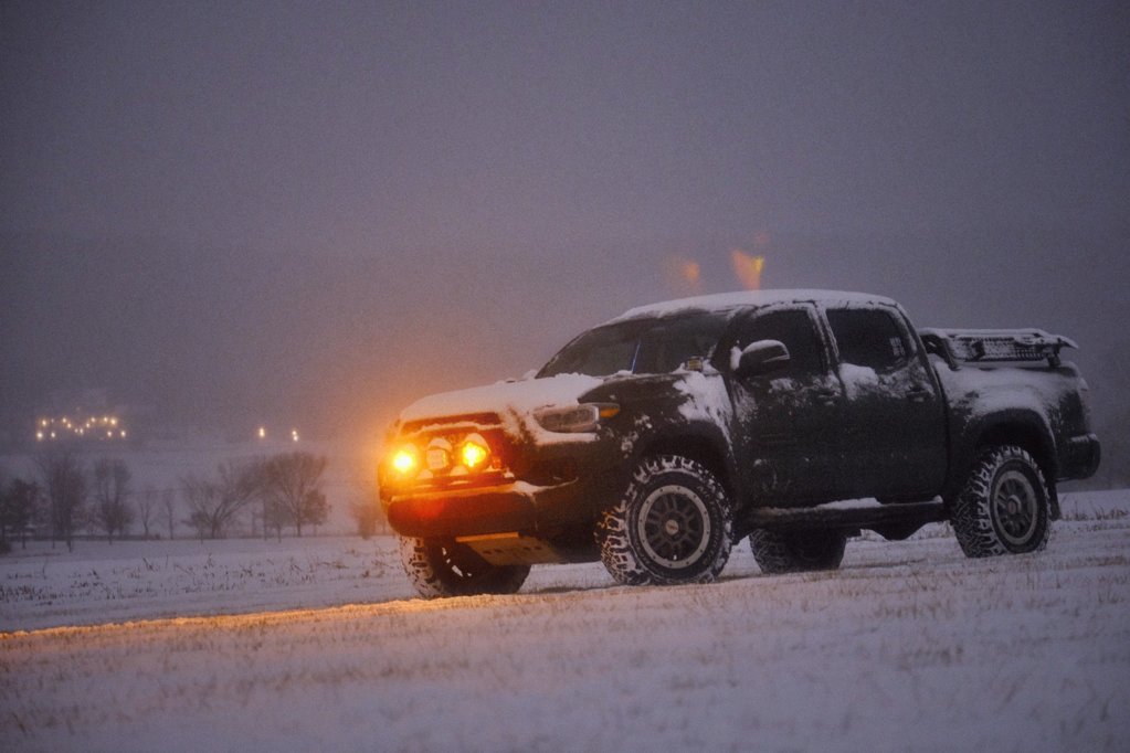

    Thank you, and yes I am in south eastern PA.
    sorry I forgot to answer your initial questions,
    • What kind of Taco do you have?
      • 2021 Taco TRD Offroad stock suspension
    • What kind of driving do you do?
      • 90% on road, 10% offroad if that.
    • What size did you get?
      • 265/70r17
    • What load rating did you get?
      • load range E
    • How many miles do you have on them?
      • two oil changes, so close to 10k miles
    • Would you buy them again or go back to the KO2's?
      • had 4-5 sets of ko2's on my previous vehicles and I am 100% happy with KO3. It does great on road and off road, I have driven on the beach, rocks, grass field, through Boston snow storm, handled very well.
