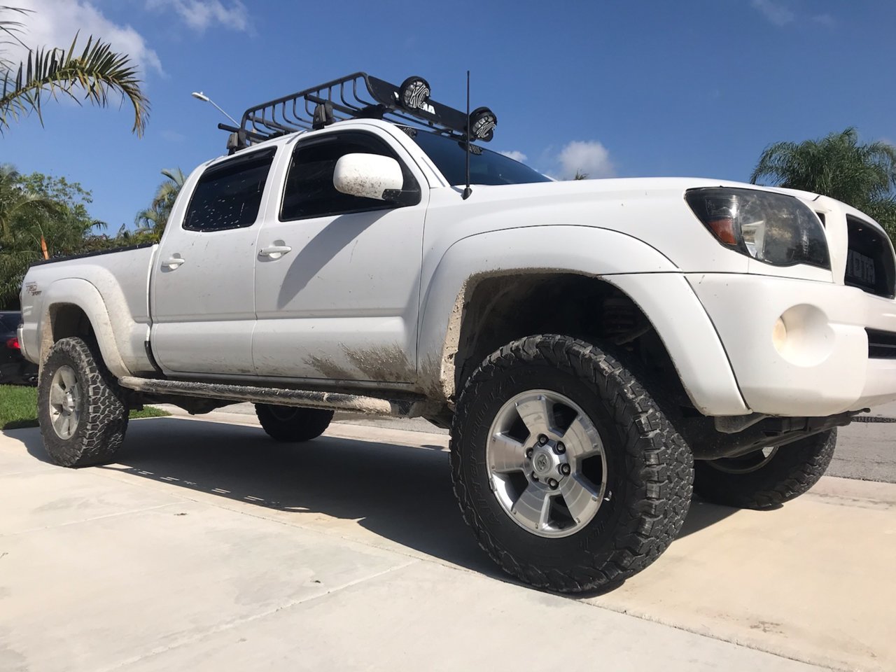

    Was looking at Falkens, but came across these for $160 a tire a couple months ago so I picked em up. Finally installed them a few weeks ago and Im happy so far. Haven't been off-roading yet, but the ride is smooth and quiet. These replaced the 265/70/17 Toyo Open Country A/T Load E I had on. Those Toyos, to me, felt more stiff and rough than the KO2s. No issues balancing, no issues in the rain, and the ride comfort is great. We will see how well they perform off-road when the time comes. I only take a couple off-road trips a year so this thing is 90% on road. I thought I was going to lose some mpg but it seems I've actually gained. After doing some research, I believe these are lighter than my Toyos. What I do need is new mudflaps now.
