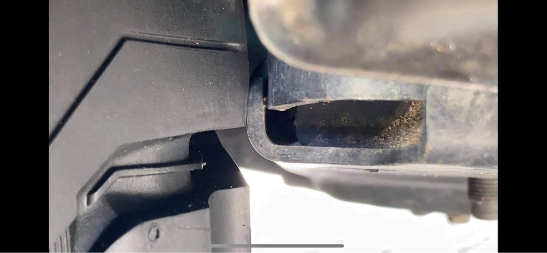

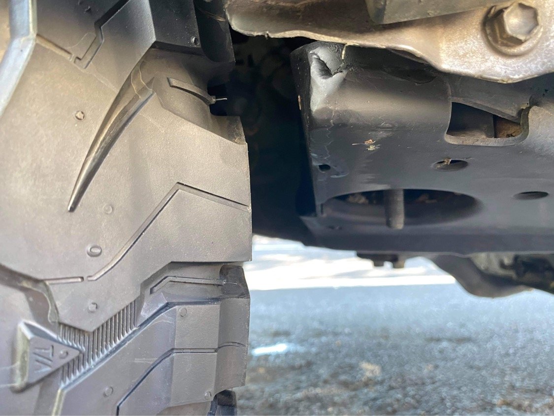

    Are you keeping OEM wheels? This plays a massive role in the rubbing situation. You need enough backspacing (determined by offset and wheel width) to not rub on the suspension itself (upper control arm), but if the wheels stick too far out then you are more likely to rub as well. I’m running 17x8.5 wheels with 0 offset. Seems like the sweet spot is this same size with 0 or -12 offset.
    You may not rub the 285’s right away with a 2” lift but as soon as your wheels are turned at an angle and your suspension compresses 2”… you’re rubbing. Just something to consider. Alignment has a lot to do with it too - specifically caster (how far forward the wheel sits inside the wheel well away from the cab mount).
    There’s quite a few parts to consider. I’m happy to offer whatever limited knowledge I’ve gathered around here the last few years if you want to message me…
    For reference, here is a before and after of the front driver’s side 285 tire rubbing before and after CMC. This is with the steering wheel turned about 40% to the left. Not MAJOR but worth doing the CMC. Again this is with no lift!
