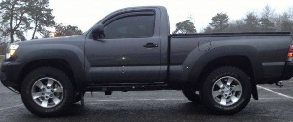

    Anyone running this size of bfg at KO on a stock gen 2 taco? With these tires having stuff a square shoulder to the tread, seems they will come very close to rubbing when the steering is turned.

    Should be okay.
    Remove the mudflaps.

    I have without a problem. I am lifted 3" now, but originally ran those tires on stock sport rims, no rub.
    edit : and stock suspension.

    This is the size and Tire that I'm running without a lift. They came on the truck when I bought it. The front was demudflapped though so there might have been some slight rubbing but it doesn't look like there could have been too much.

    BFG AT's 265/70/17 are fine with stock wheels and factory suspension. I ran that the day I drove my truck off the lot. Changed the wheels which had a different offset and it rubbed.

    I just had Duratracs installed yesterday in that size. With the wheel cranked all the way to the left and going in reverse, I rub on the mini-mudflap on the passenger side that is on the front of the wheel well. Only issue i've come across so far. Doesn't do it on the driver's side some reason.

    Ive got 265/75 16 on my 12, OR wheels, and a buddy has 265/70 17 on sport rims on his 12. Both of us have stock suspension. We both trimmed the mudflaps and removed the small flaps in the front of the wheel well on the bottom of the bumper. No rubbing for either of us.

    i had 265-70-17 grabber 2's same tread and size never had any issues however i have 4 runner sr5 rims and the stick out about 1'' more than the stock rims.
