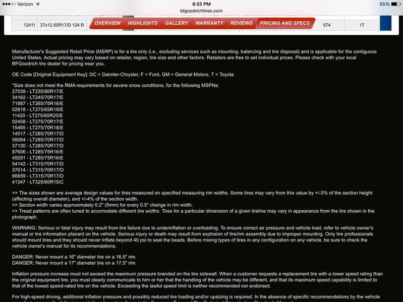

    Also noticed this disclaimers about snow conditions and not meeting the requirements for the size I'm looking for ......I'm in Maine.....should I be worried?
