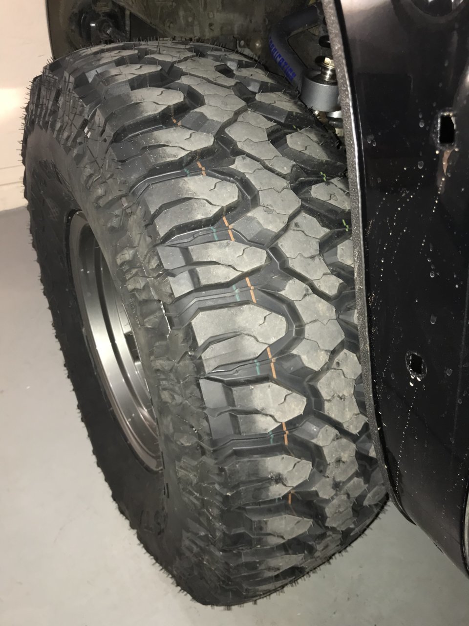

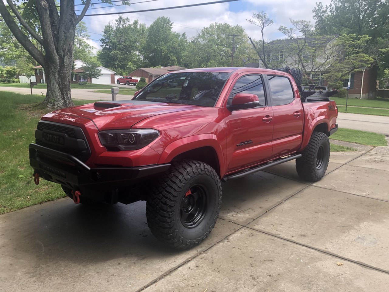

    I run 40 in my 315/75-16 5DDEA9EB-574A-4C32-842B-F3B34E2B11E5.jpg

    @splitbolt what would you say the correct pressure is for 315/75/16’s? Much like this guy, I have a set going on soon too.

    Hard to say...
    You need a PSI that gets you 1,954 lbs of load capacity.
    At 35 PSI, LT315/75/16s have a load capacity of 2,535 lbs. Charts don't go below 35 PSI for LT tires.
    A LT315/75/16 is very voluminous, requiring less PSI, all other things being equal.
    I'd start with 30 PSI, and wouldn't be surprised if you end up around 25 PSI.

    37 PSI cold @ 70°F

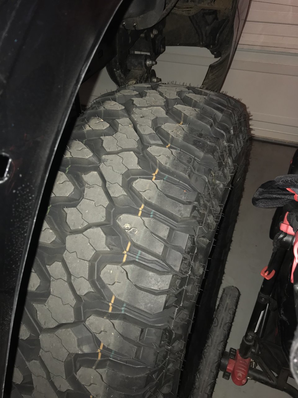

    These were my 315/75/16 at 35 psi cold. Only weight on the truck is steel sliders and skids. CLEARLY over inflated. I’m going to try 30psi and do a lazy man chalk test

    IMO 40 is MOST DEFINITELY over inflated. Draw some chalk across your WHOLE tread and drive up your driveway. I can nearly guarantee you won’t see all of your tread footprint on the driveway. You’re over inflated! Sick truck though
