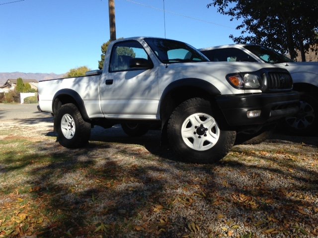

    You gotta post some photos, I'm dying to see the STT Pro's in that size. The 2nd gen 5 spoke steel wheels do indeed have 5.25" backspacing. They should be fine on your 2nd gen, since they were designed for it. Right now I have them on my 1st gen and just discovered a bit of frame rubbing, so I'm going to try some 3rd gen 4runner wheels with 4.6" backspacing. Hopefully that will fix it.

    I had my ST Maxx 235/85's remounted on 3rd gen 4Runner wheels and no more rubbing. Tested them thoroughly this time. Had to go white instead of black because I have a severe phobia of my truck looking like a hovercraft after sunset:

    no problems whatsover! and no rubbing either.
    djb1 - that looks badass.
