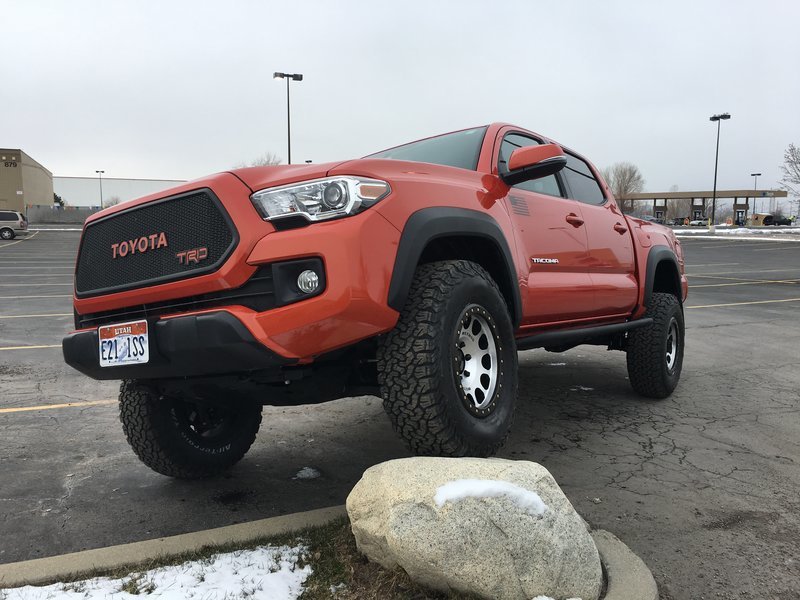

    IMG_3788.jpg IMG_3795.jpg IMG_3788.jpg Got mine.

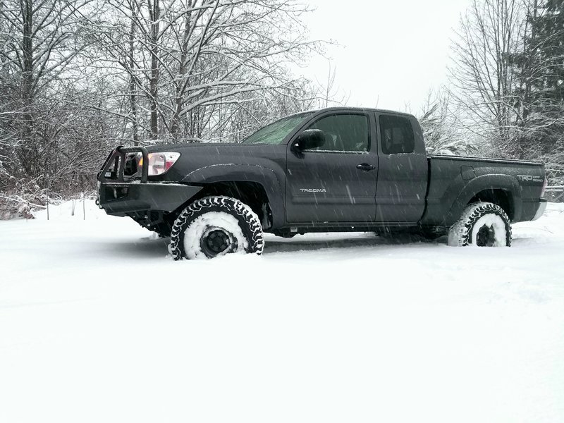

    Arb bumper, OME 886/dakars 265/75r16 ko2s
    I'm running the 34s too. Sorry, not the best pic of them with the snow. You can run stock gears with them but you do feel the difference. Not heavy at all thou since they are load range D not E. They weigh 52lb each compared to the same tire in 265/75r16 load range E which is 52lb. I'm getting 15 combined 18 highway

    What are your measured tire heights with those? I hear they run a lot shorter than advertised.
  8. Feb 26, 2017 at 10:14 AM
    Sloth
    Sloth Baby Ruth?
    Nov 16, 2012
    #91263
    12,567
    Seth
    Democratic Peoples Republik of Massachusetts
    07 FJ Cruiser, 98 Landcruiser
    Stuff
    Listed tire heights are mounted on a rim not installed under load on the truck
  9. Feb 26, 2017 at 10:15 AM
    i_cappi
    i_cappi Well Known Membhair
    Jun 30, 2015
    #158483
    2,359
    Canton, Oh
    2011 TX TuRD Pyrite DCSB
    Ya like a alot shorter, I bet thier not even 32" mounted.

    Nope thier 32" mounted and on the ground...just gone done doing some googling.

    I just measured my 265/75/16 KO2s and came in at 30.7" with about 10k miles on them and are a bit low on pressure as they sit. It's hard to image the 34x10.5x17 only measure out at 32"
  14. Feb 26, 2017 at 10:29 AM
    i_cappi
    Jun 30, 2015
    #158483
    2,359
    Canton, Oh
    Ya thier ranging from 32-32.5" no where near advertised size. It's BS really.

    I get 32 1/4" at 35psi on a 7" rim with the weight of the vehicle on them.

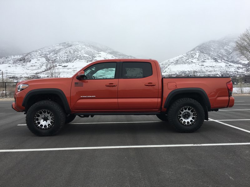

    IMG_1952.jpg 34x10.5 checking in. If I remember correctly, mine measured 32.5". I can double check a little later.
    I have heard that with a smaller width wheel, the height tends to increase slightly. I'm running SCS wheels w/ 8.5" width on my setup
