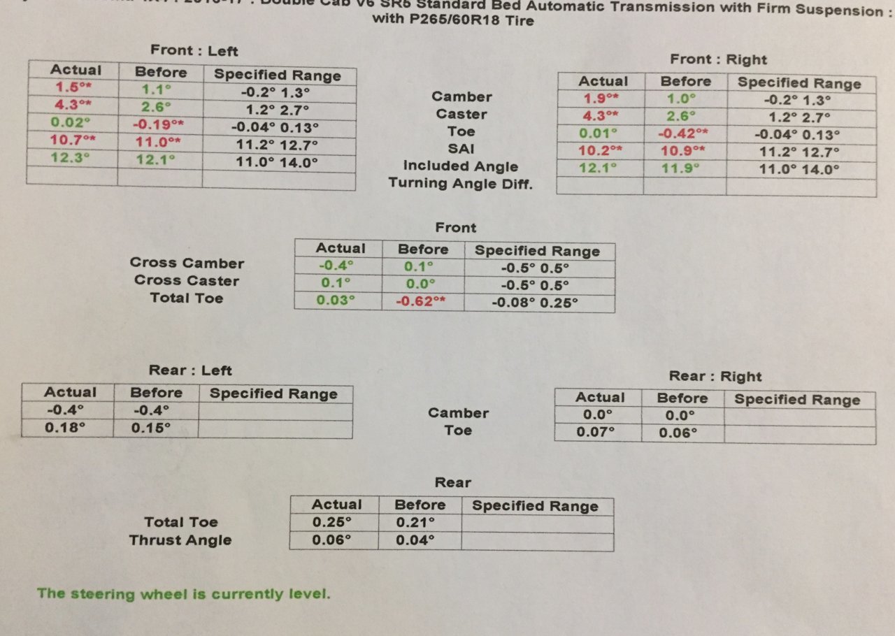

    Running the BP-51 kit.
    I have my alignment specs, but they're off. I'm actually rubbing MORE after the alignment. Making another trip in to get it dialed in. I took it to Firestone and "THE guy" wasn't working (found this out after-the-fact). Here they are anyways...IMG_0391 (2).jpg

    Camber and caster are very high

    Agreed - trying again on Monday. Hopefully the "veteran tech" can work his magic
