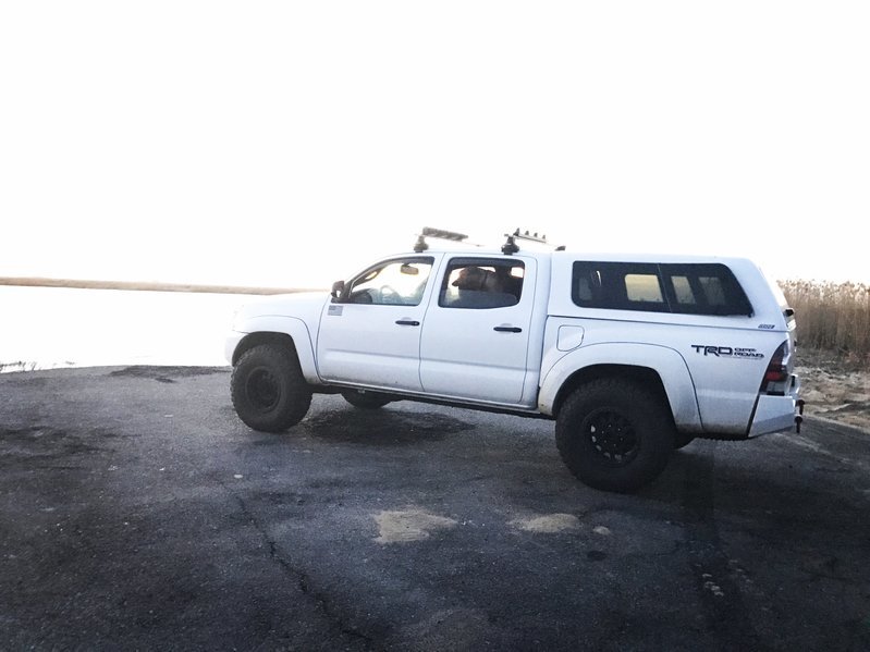

    Yes they will fit. I have about 1.75" of total lift with that tire size. Zero rubbing. IMG_1590.jpg

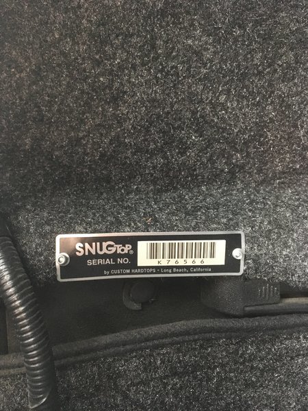

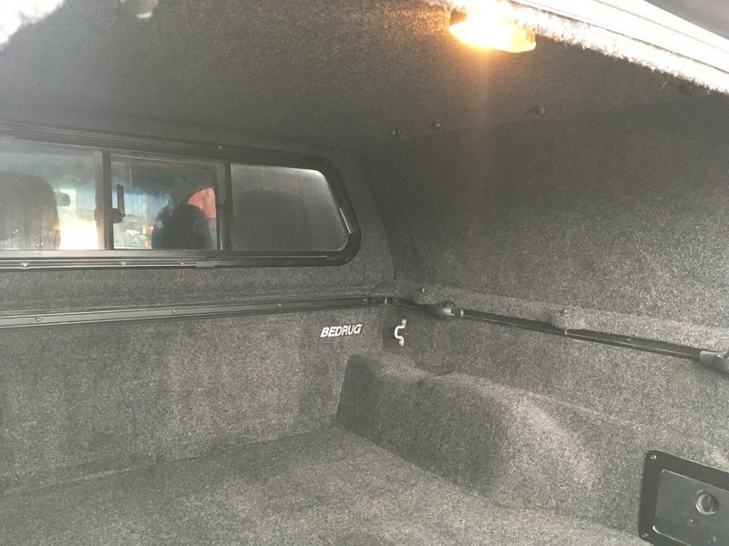

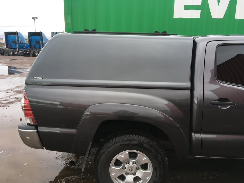

    What kind is snugtop? Is it the plus height model?

    Also interested in the snugtop. What color and bed size as well.

    IMG_0588.jpg IMG_0591.jpg IMG_0585.jpg It's magnetic grey, with carpet for truck bed.

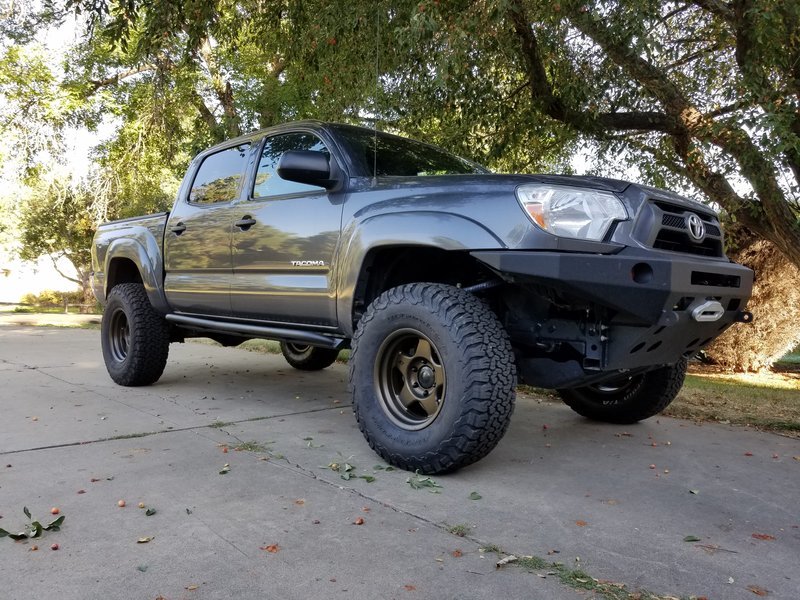

    I think it's hit or miss if you'll have any rubbing. I have the same wheel and tire combo and the cab mount chop was a must. I had major rubbing at full lock but once the cab mount was chopped, the tires fit great.

    Do you have a picture of the the front view?

    Don't get me wrong, I'd do it again in a heart beat! I love the larger tire and having the additional clearance. My stock tires looked way too small on the lifted truck.

    My lift is right at 3 inches.

    The offset on those SCS + the wide tire looks awesome. Do you run spacers?

    Thanks! I'm extremely happy with the look. No spacers just the 3.5 back spacing on the wheels.
