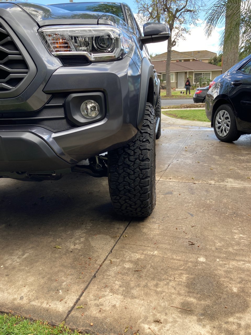

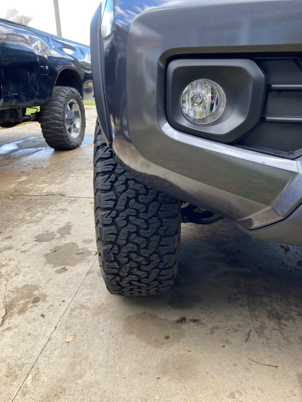

    Hey guys got around maybe 1000 miles on some k02 and the passenger side is wearing on the outside real quik, I do make aggressive right turns but the rear is wearing as well, I checked and I have 40 psi every wheel with maybe a 1 psi difference at times, pretty stable. I am lifted on 6112 with the driver side 2 notches bite to account for Tacoma lean no lift rear, and from the measurements from center bottom of tire to bottom of fender flare I’m sitting at
    38 1/4” driver side front
    38 3/8” passenger side front
    37 5/8” driver side rear
    37 1/4” passenger side rear
    these numbers no one inside the vehicle no cargo.
    Picture of driver side front and rear
    pic of passenger side front and rear
    Should I rotate already, alignments seems perfect car is straight as an arrow and does not pull to the right. Is the Tacoma lean lift putting to much pressure on the passenger side?
