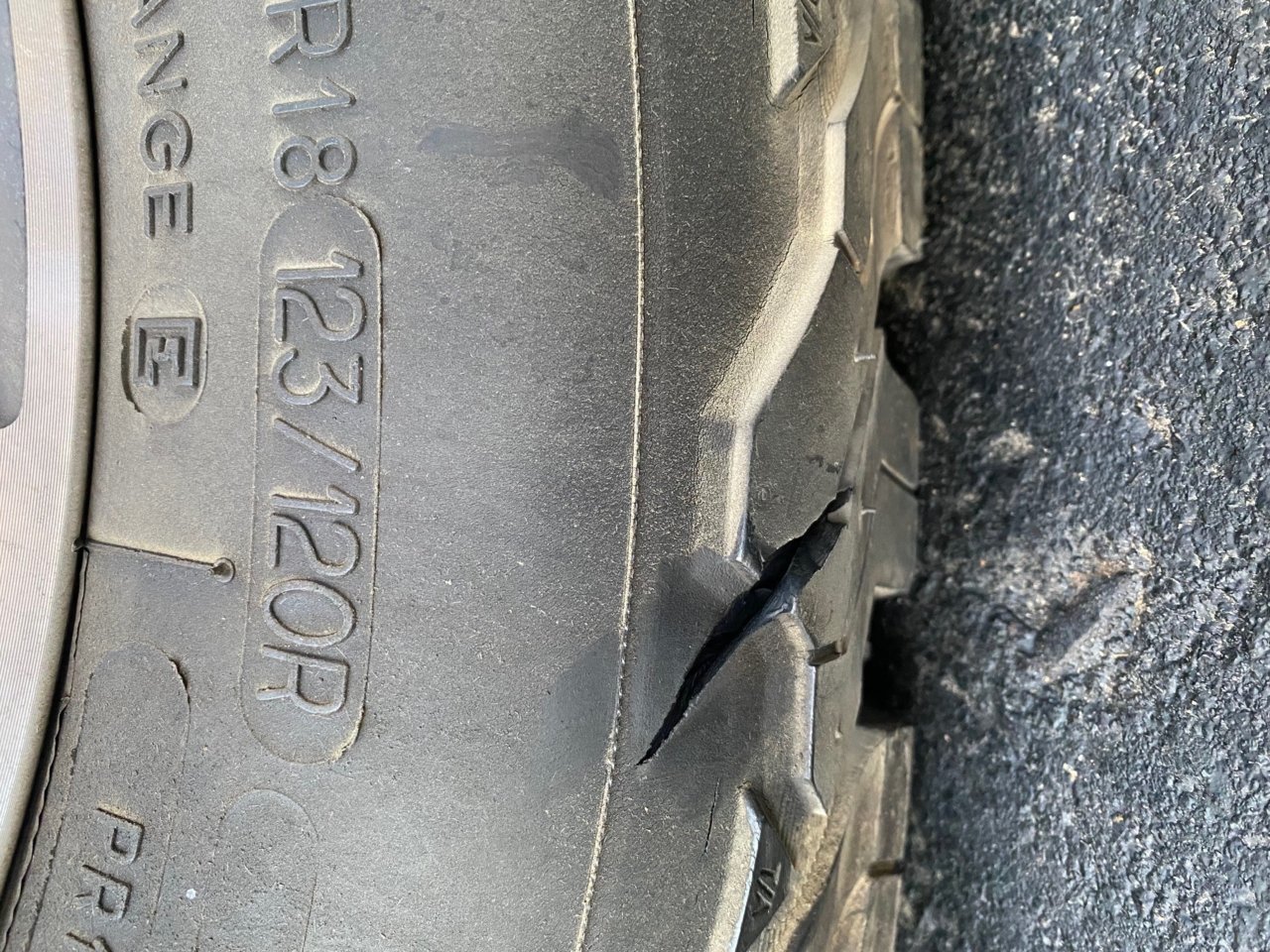

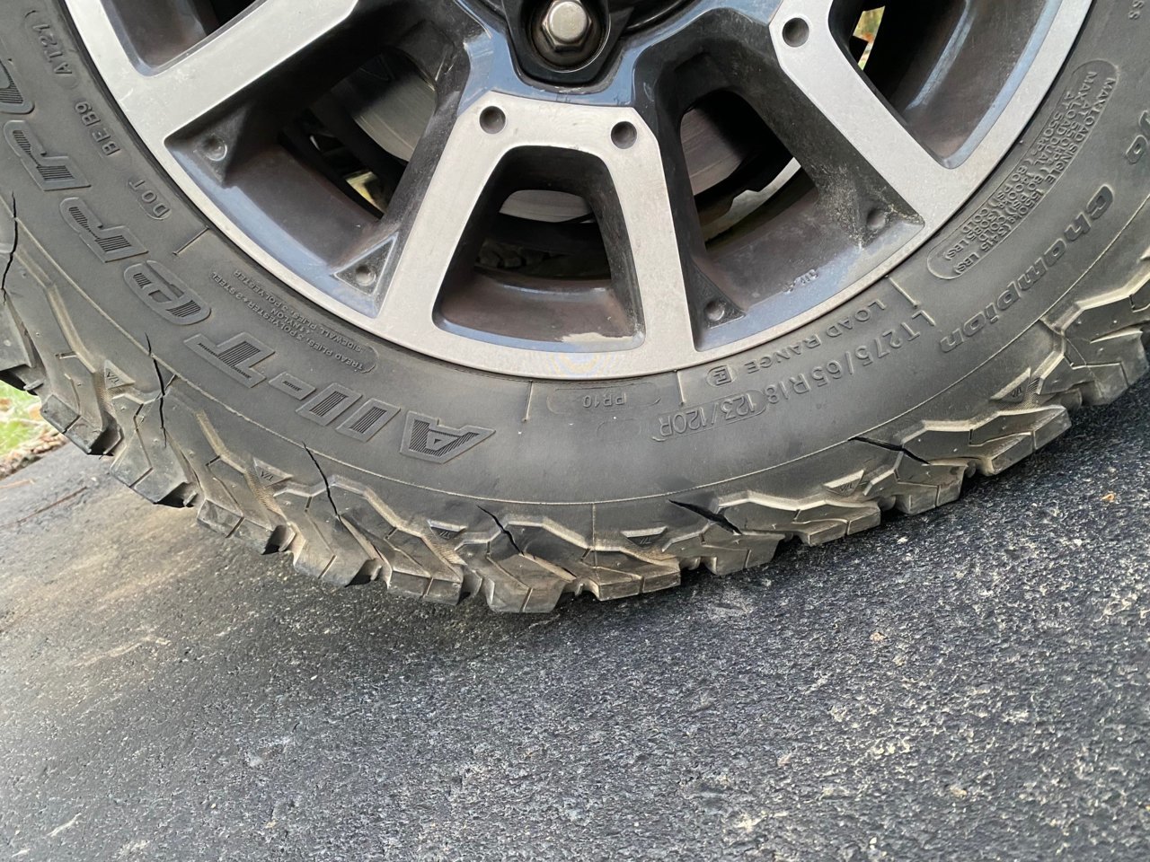

    Dad sent me these pictures yesterday. I've never seen a tire fail like this before. These gashes are at almost a perfect interval all the way around the tire. The tires came with the truck last year and were basically brand new when he got it. He noticed after a 300 mile roadtrip, and it didn't happen gradually. Other 3 tires are fine. Tire pressure was 35 all around.
    Any ideas of how this might have happened? Is there any recourse with BFG since he didn't buy the tires himself?

    35psi on a load range E tire, that could possibly be the problem. They look like they have air cracks in them as well.

    That many cracks and no signs of being thrashed... Im going with manufacturing defect.

    Those cracks are all almost exactly the same and equal distance from each other. It is obviously manufacturing defect. It’s possible they could cause catastrophic tire failure at high speed causing injury or death. I’d submit the pics to BFG. In this case they may likely do something about it. If they hesitate I’d tell them that you are going to various media outlets. There are likely other tires like those out there that once discovered could cause huge problems for BFG.

    Yup, defect. Fairly rare. Without proof of purchase, I think you're SOL. You can ask a tire shop to make a claim, but any claim I've seen you have to be the purchasing owner.

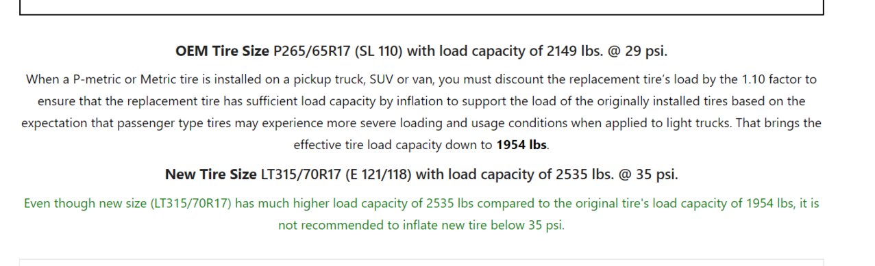

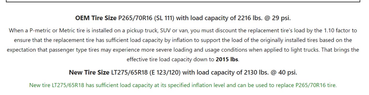

    Just because people do, doesn't mean they are correct :) Might not be an issue for 90% of the time/people... until something like this happens??
    Click link to calculate proper tire pressure based on various sizes and P Metric vs LT: https://tirepressure.com/tire-pressure-calculator
    How is the tire not flat with gashes like that?

    No idea how it's still holding air. Like I said this was right after driving 300 miles back from the Mississippi delta. If that thing decided to go on the interstate, it would've been catastrophic. He was towing a trailer with 2 four-wheelers too, which makes it even scarier.
    Should also say that this was on a 2014 Tundra, and Toyota recommends a higher psi for the larger truck. 35 psi is still well below the max pressure (80psi).

    Michelin/BFG uses very soft rubber compounds. Dry rot or manufacture defect.

    Clancy
    Vancouver Canada
    2009 AC 4X4 2.7 5M
    Good link.
    I too ran my LT's at around 38PSI (calculator said 55psi). I have usually run my P's and LT's at the same pressure unless fully loaded or off road, and always have equal tire wear. I think another metric would be to monitor tire temps at the same psi between a P and LT rated tire. Temperature is the real culprit with tire failure.
    In regards to why aren't they flat, I would guess that it is because of the ridiculously strong 3 plies in the KO sidewalls.
    Looks very much like a manufacturers defect to me.

    Man, if I did 80psi on my ST Maxx on my 4.6K lb Tacoma it would ride like an Amish wagon. When in doubt, do the chalk test. Then fine tune to what feels right.
    but there’s no way tire pressure caused that failure. It was a bad tire plain and simple
