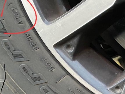

    I agree it looks like a bad tire with the cracking the way it is in so many places.

    That's a defective tire. Let BFG know about it, replace the tires, move on

    OP, thats a new one. I had some issues with one of my BFG in the past doing something similar, but mine were more in a circular pattern after thousands of miles aired down on dirt roads. Unfortunately cant find the pictures, but the cracks made a circular pattern on the sidewall roughly where the lugs began. Unlike yours which are more perpendicular. Eventually one of mine did fail on the road, though it was not catastrophic. I had enough to time to pull off.
    All that said, I do see some dry rot / cracks in your pictures. How old are those tires?

    Pretty sure the first 2 digits are the month, and the last 2 digits are the year of production

    Check the date codes for us -- that would be interesting to know.
    The BFG All-Terrain T/A KOs (not KO2s) on my Gen 1 Tacoma have that same circumferential cracking, @SR-71A. I flagged them doing inspections on all my vehicles a few weeks ago. These have 63k miles on them, and mid-February 2012 production (0412). They're on the list for replacement. I can't say they owe me any more than they've given already!
    (I gotta get a better photo -- or at least one in focus!)
    No, the date code is in the format NNNN where the first two digits are the week of production and the last two are the year. The sequence you have circled is BFG internal information. Note that if the tires have raised white letters, the date code will be on that side.

    My brother-in-law had that same exact failure on his BFGs. Went to Goodyear as a result. Glad to see you caught it before it left you stranded or worse.

    The cracks are in the outer layer of rubber and haven't gone through all the plies.
    My Subaru's 6 year-old Cooper street tires have similar cracks on all four, still driving with them daily with no issues.
