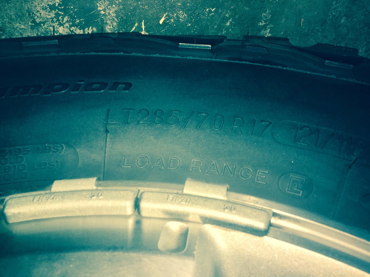

    285/70/17 on stock sport rims. What would you use on PSI

    LT, P-metric, or ISO-metric? If applicable, load rating number?

    Load E sorry lt I think

    Originally it had 265/65/17
    Now the bfg k02

    I'm going to assume they were a SL/110 load index. At 29 psi this gives a load rating of 2,149 lbs for P metric tires and 1,954(2,149÷1:1) lbs for LT tires.
    Here's the thing about big volumous tires such as yours; 1,954 lbs is below what the load charts list. 35 psi gives a load rating of 2,105.
    But, in the 35-45 psi range, 1 psi is about 40 lbs...so, at 32 psi, it should give you a load rating of about 1,985 lbs.

    Seems right. Basically you need slightly more pressure to inflate a stronger tire to meet load ratings. That tire is capable of running 80psi for heavy loads, so youre basically running around 56% inflation. Your stock P tire max inflation is 51psi so at 29psi stock your are again 56% inflation.

    And... it needs less pressure in a more volumous tire, all other things being equal; namely load index.

    After reviewing this again; they also gave you the load rating of a P metric. The tire that comes on the 3rd gen Offroad is ISO metric. This gives a load rating of 2,149 lbs at 30 psi; not 2,234.
    This gives a load requirement of 1,954 lbs for LT tires. An LT265/70/17 has a load rating of 1,964 lbs at 37 psi.

    you're good with w.e. math your doing lol thanks ill pressure mine at 32. thanks!
