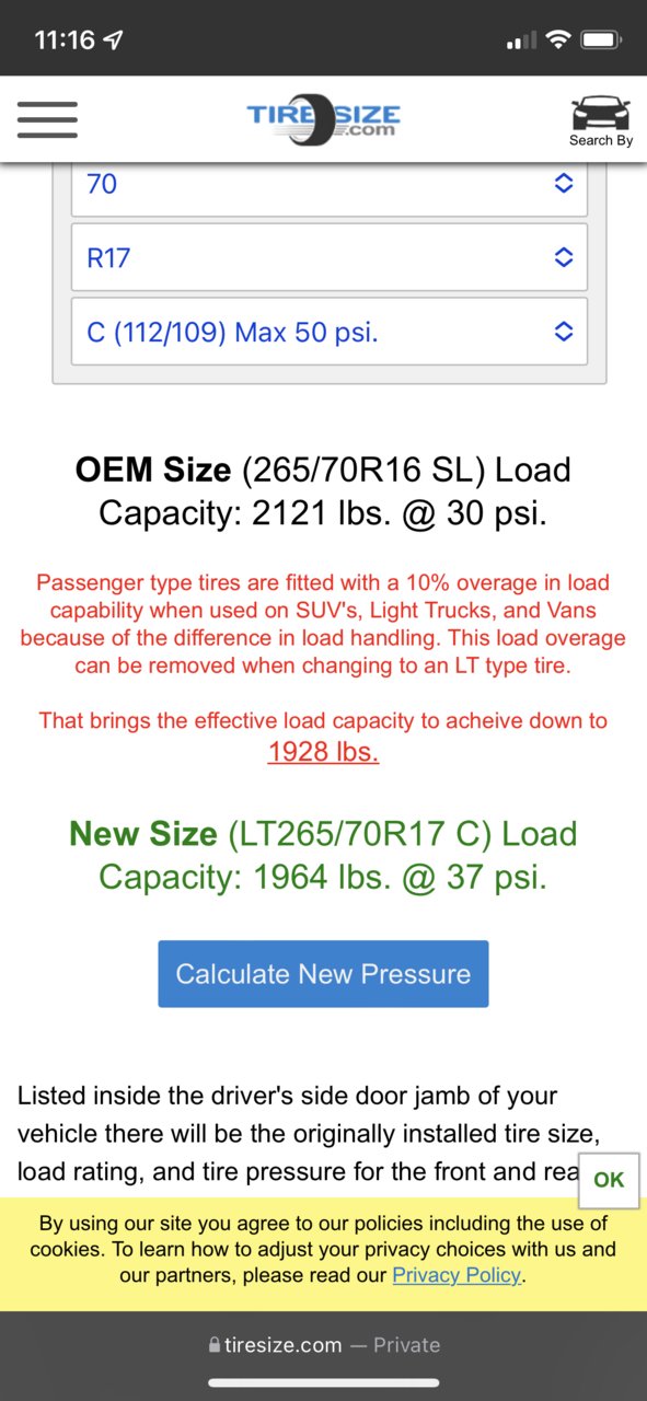

    Your OEM is not P265/70R16 SL(p-metric).
    OEM is a 265/70R16 112(euro-metric).
  16. Dec 26, 2021 at 8:16 AM
    #56
    aleriance
    aleriance Well-Known Member
    Mar 20, 2017
    #213857
    619
    Jorge
    Naples, FL
    2017 TRD Off-Road 4x4
    CMC 285/70/17

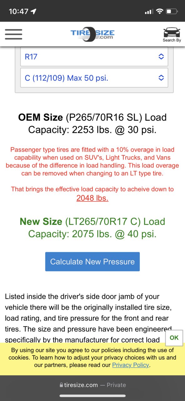

    Here’s the correct one then:
    Mt133677 likes this.

    What’s the link you are using for the conversion on tiresize.com?
