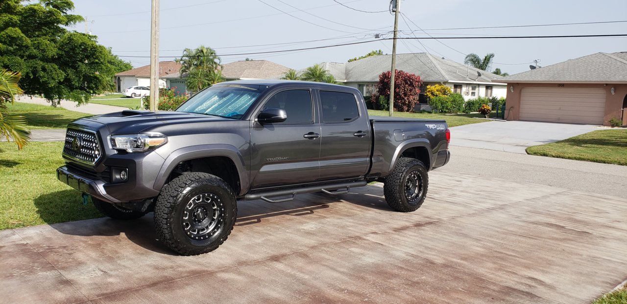

    20180809_174100.jpg I have had a slight vibration in the steering with my KO2' when I was on the interstate the other day. I went to the shop and the tech noticed some of the balancing weights on the front wheels came off. They are applied on by adhesive. I've been in water and mud few times since I had them on in July. He said that does it.
    He balanced them again. It rides fine locally. I'll jump on the interstate tomorrow morning and see how it feels.
